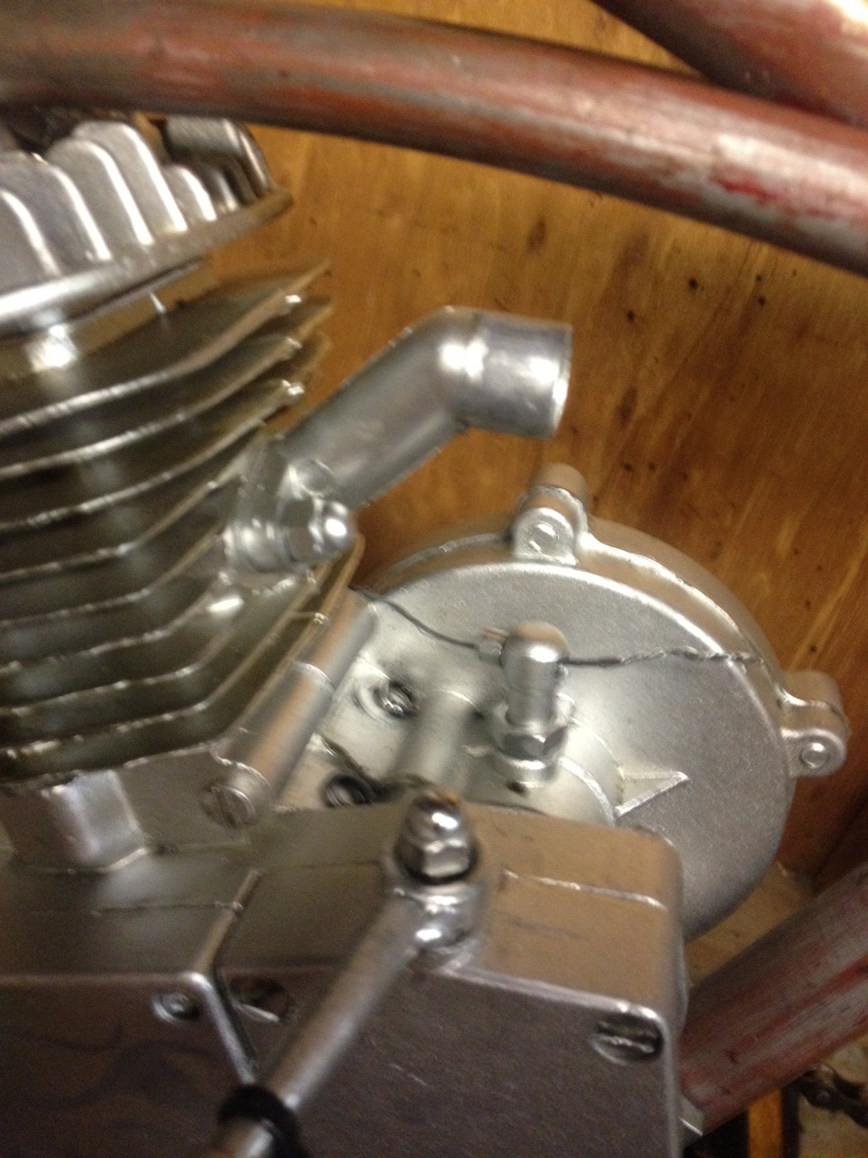

sorry for some reason my phone was having trouble sending my images last night but here are a few pics of the build as it is starting. im waiting on ups to drop off the black engine kit for it sometime today.the engine on it is just for test fitting to see what problems i will run into.
this is a "customers" bike. meaning i built mine and a buddy of mine wanted 1 so now here i am building his 73 stingray. he likes the "rat" look and will probably just clear over the frame as it sits. i will keep everyone posted as we move along. thanks for all your help and suggestions. if any1 has done this bike b4 and has some extensive knowledge as to is im doing something wrong. please let me know. :-||

so just an up date. i think i got eveything figured out as far as the carb fitment. once we pulled the crank we were able to get the carb to fit. i already figured when i was test fitting that i was gonna need a wider crank. but with the motor sitting where it is there is no room for the sprocket on the crank. my buddy and i are looking to get into maybe a 25 tooth bmx sprocket on the crank to make room just to get the motor started. but no word yet as to when we would order it.but here is a few pics of the progress. we added some high rise handlebars and the front end from a 26" huffy. thanks for all of your help and i love the suggestions. and all the more would be welcomedance1
I found a good source of tiny sprockets was kids bikes. My WCC chopper needed a smaller crank sprocket and I found one on a kids Tonka bike. Bolted right on and was free.
