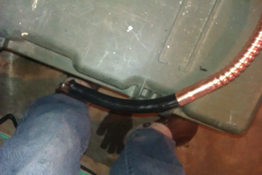

this is flexible copper pipe meant for a water heater fits perfectly over the exhaust pipe on or bikes wish i could remember were i saw this on here and give credit were credit is due .
i used some exhaust patch goop sold at any auto store to hold it onto the pipe it fit snug enough that im sure it would hold without the goop but used it just for the air tight seal and to make sure it holds
haven't got to give it any test runs as my 4g i still in the mail mans truck but the pipe comes in 3 different sizes i chose the longest one exhaust sounds a lot better with it to .
