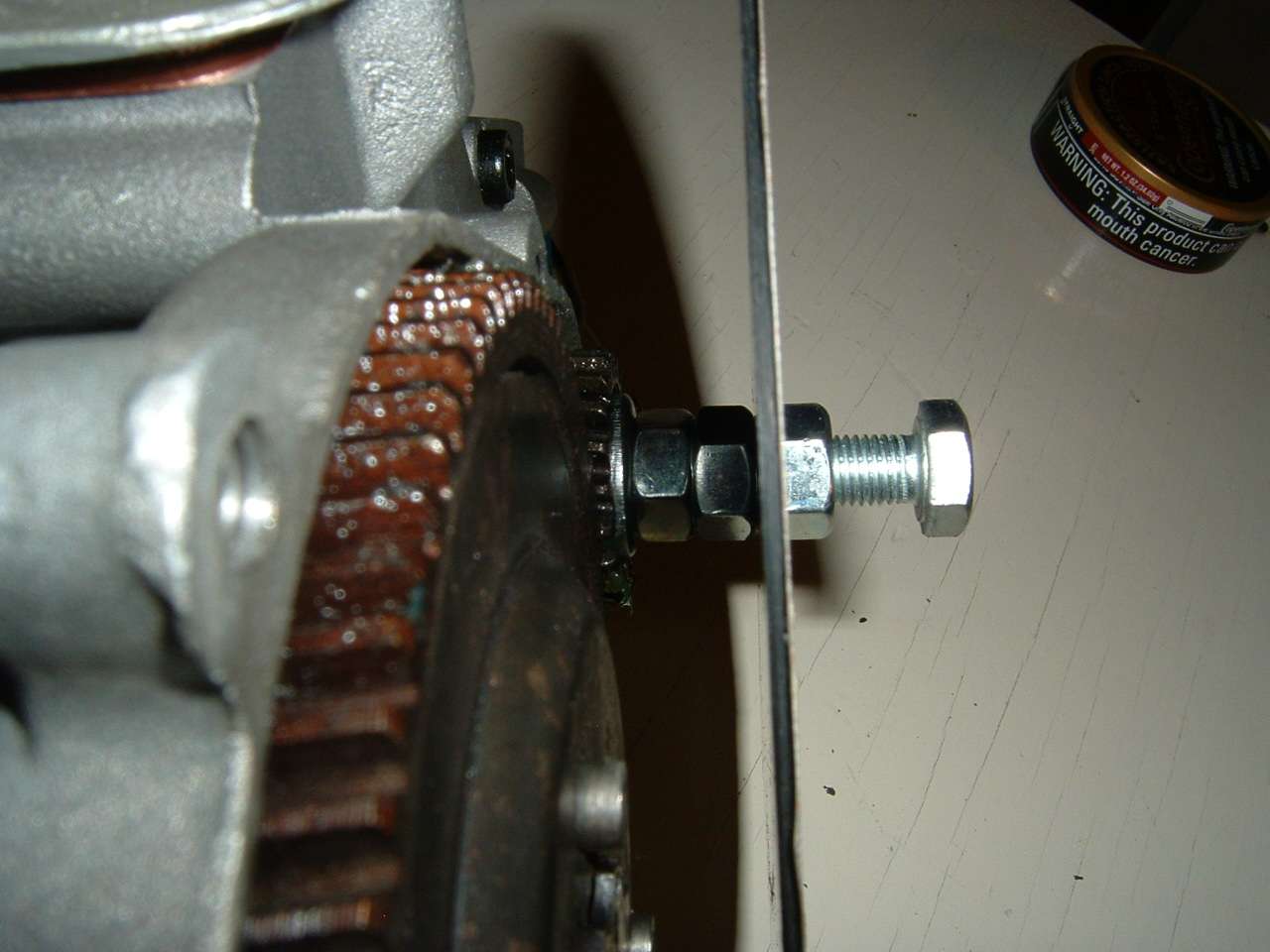

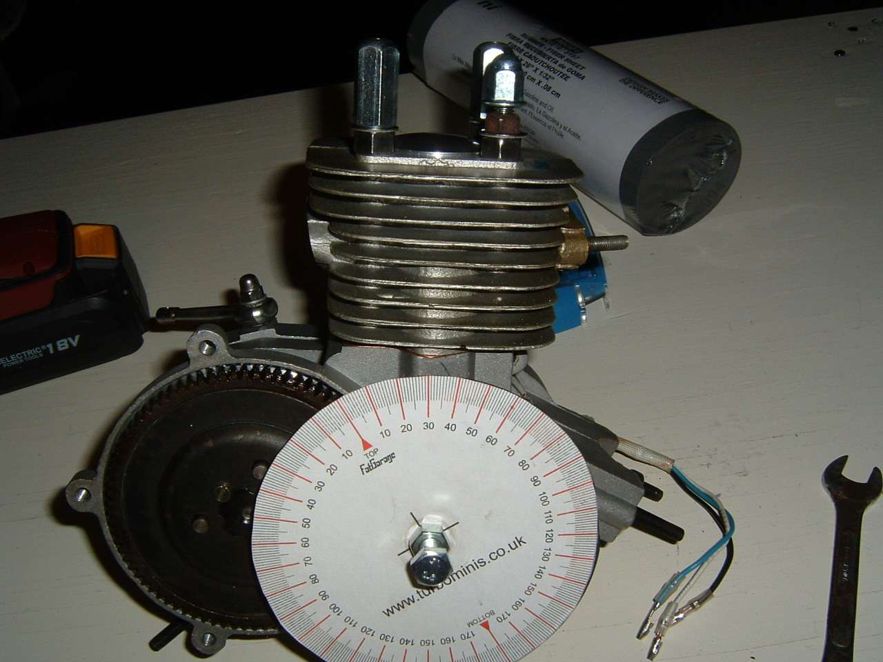

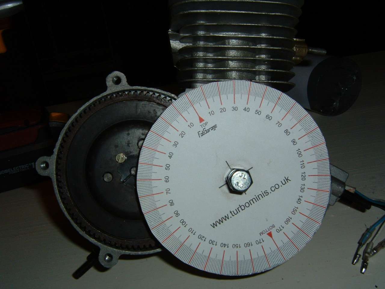

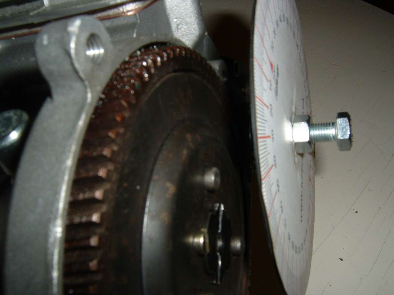

Here's mine, mine fits on the bevel gear side and I need to use a piece of solid wire for a pointer. Mine's dead simple as well because I googled "degree wheel" and selected images, the search brought up tons of different printable images so I found one that was real easy to read and set it up to be printed at 6" round on card stock. Next I got a piece of plastic sheet and cut it round, then used spray adhesive to glue the newly printed wheel to the p[lastic sheet. i then laid a phone book on top of it so the paper wouldn't wrinkle as the glue dried. After about an hour or so I driled an 8mm hole thru the center and used an M8x1.0 x30mm bolt with 3 nuts.
To mount the wheel to the engine, I take out the bevel gear screw and screw the wheel into it's place, use one nut as a jam nut to lock the bolt in position, then use the other 2 to lock the wheel into position once I decide where I want the Zero to point to.
I really like the idea of the neo magnets, they'll stay put without the need to remove the bevel gear screw. I ended up making a better pointer out of a piece of aluminum and it can be mounted to the clutch cover bolt holes the same way with 1 jam nut to keep the bolt from moving, and 2 more jam nuts to lock the pointer into position. It's still real easy to set up as it can be put on and taken off in about a minute. The magnets would cut that time down to a few seconds tho...
