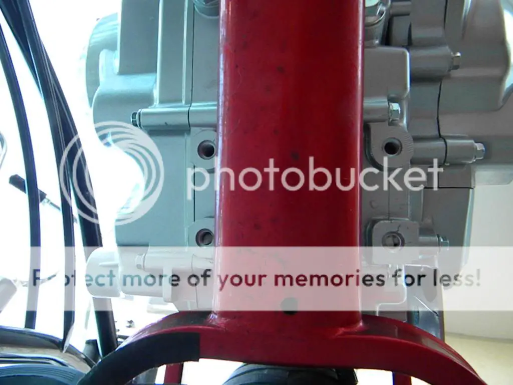

Thought I'd share a some beginning photo's of this new OCC-Stingray Chopper 110cc Lifan build, with everyone, I have taken 32 photo's since starting this build today.
One reason for taking so many photo's is to show newby's & veteran builders that these 50cc / 110cc horizontal 4-stroke Honda clone motors will fit most Stretch Cruiser's & choppers with a few modifications.
One of the first modifications that I had to make is removing the seat down tube, removed it with a 4-1/2" grinder using a cut wheel, if you don't have one you can pick one up at your local harbor freight tool stores for around $18.00 USD make sure you have 20% off coupon get the extra savings, just have cashier ring all your item's separately.
Here is the Link for the harbor freight 4-1/2" Grinder:- Harbor Freight Tools - Quality Tools at the Lowest Prices
I save the seat down tube just in case it's needed later! I made the mistake of throwing away parts before only to have it haunt me.
Next step is to weld in a skid plate for motor to sit on, for welding this skid plate I'm using a throw away welder from harbor freight it will cost you about $80.00 on sale and with a 20% off coupon.
Are you scratching your head did Crazy Horse just say a throw away welder, yes I did. I call it a throw away because it's very inexpensive and can handle welding on bicycles. This welder by harbor freight is the 90-Amp Flux Cored Welder: Here's the Link: - Harbor Freight Tools - Quality Tools at the Lowest Prices
So I placed the motor inside the OCC-Stingray Frame after removing the seat down tube, and what do you know the drive sprocket and the rear free-wheel line up perfectly, I'm loving this build more and more, the motor sit's perfectly centered in the bike frame.
Next modification will be the pedal crank arms, the crank is wide enough to clear the jug / head on the motor, but the crank arm's need to be shortened.
Next modification is the chain ring on the pedal crank, will try a few different chain rings to achieve a balanced look.
Very important modification if you choose to modify an OCC-Stingray for a Horizontal Lifan 50cc 4-stroke, it is imperative to reinforce your frame weld in a brace on both side's of the frame from your chain stay to your seat stay, or you can take a chance and ride at your own peril. Just a suggestion!

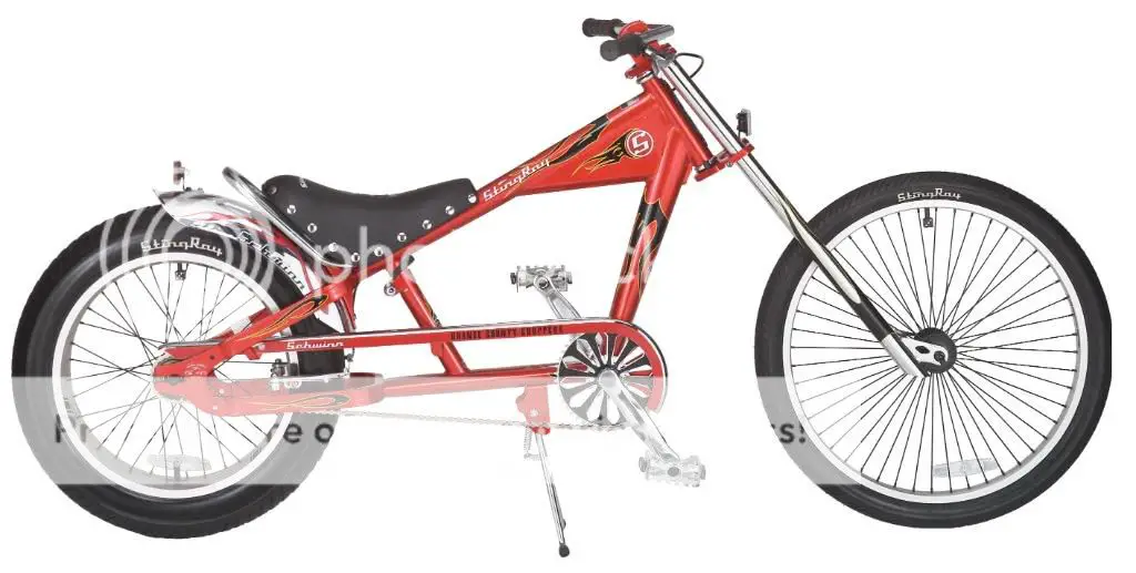

This chopper style bicycle is beautiful and will catch everyone’s attention when you are out riding. It comes in shiny black and includes a chrome rear fender, red decals and dual front and back coaster brake. This bike is ideal for anyone between the height of 5’ and 6’. While this bike is fun to look at it can be difficult to learn to ride due to the fact that it is stretched out longer and the seat is positioned lower to the ground. Because of this bikes unique features a professional should assemble it.
This bike is much longer especially the horizontal bottom tube from the bottom bracket ( pedal crank), to the chain stays.
Which give's you plenty of room for the 50cc horizontal Lifan 4-stroke motor, you probably wouldn't have to remove the seat down tube on this chopper due to it's length!
Here's a photo of the XL-Chopper, I would guess the XL means extra long;
Here's a photo of the stock OCC-Stingray Chopper:
Notice difference in length of the bottom tube compared to the bottom tube on the XL-Chopper!
Here's a better photo of the XL-Chopper:
Last but not least my OCC-Stingray Chopper:

My suggestion is, on the bottom of the engine there are 4 holes that you can use to mount a skid plate. These four holes would normally be used to mount the foot peg bracket/arm.
Then once you have that bolted to engine line it up on the frame the skid plate that is and weld it in place.
Don't forget you really should weld in a brace to support from seat stay to chain stay, since removing seat post you've lost some structural support, this new brace should be sufficient
The engine can be lined up perfectly so that the engine drive sprocket is perfectly lined up with rear wheel.

Here's a pic showing the four ( 4 ) holes on bottom of engine, that you'll be bolting your skid plate to
