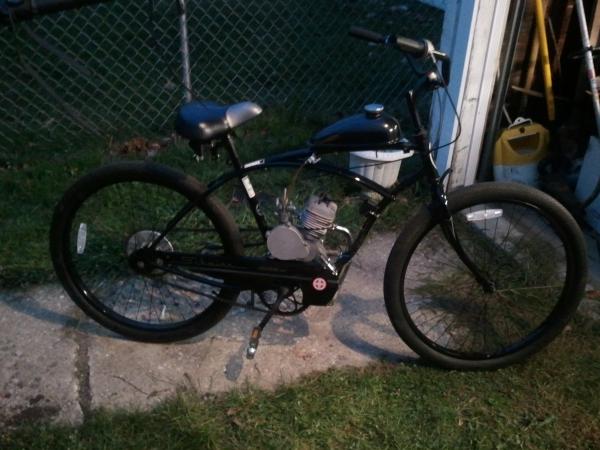

UpDate: 4/12/2013 well had our first problem with the ol girl this week, my son was ripping down the street and before i know it he is all bummed out and walking it home :(.
I said from a distance "this cant be good :). so he gets up to me and I see the motor hanging off to the right side of the bike at a 90 degree angle. seems the front motor mount studs sheered off and the motor twisted right around. well 2 drill bits an an easy out i managed to save the little girl and we did the T-mount with rubber. re-drilled and re-tapped all the old castings with 1/4 x 20. and used grade 8 Allen head bolts. take that China... bet it won't break off now :). back on the road again :). a whole lot less vibration now also.
