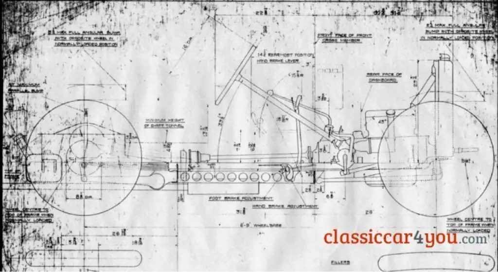

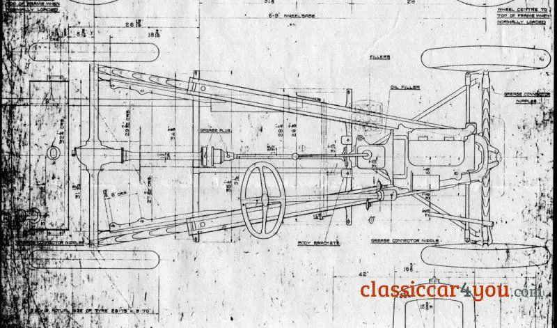

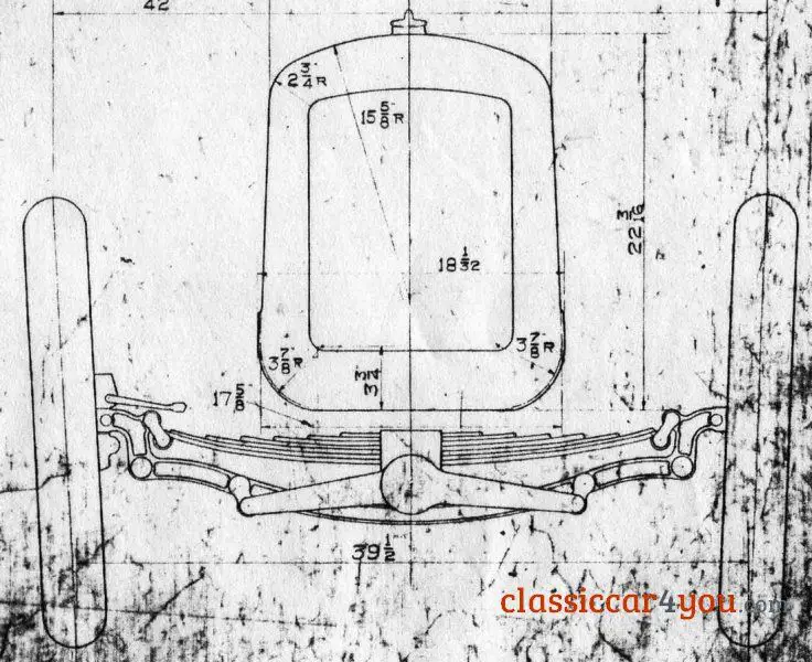

What did it have for a motor i have a E-100 perfict out of a Austin Angleia, might be a good place for it................Curt
Curt, the original engine was a dinky little flathead 4 cylinder engine of 750cc's capacity, but some folk did make specials using the E93A Ford 10 engine in this chassis which turned them into a right little firebreathing roller skate. The 100E flathead Ford engine is externally almost the same as a E93A engine except the sump is a different shape. Long ago in my twenties I built up a fully tuned 100E engine with the intention of putting it in a E93A chassis frame and I had to seriously alter the sump and the oil pickup pipe to the oil pump in order to get it into the chassis. I would imagine you would have to do the same to get a 100E engine into an Austin 7 frame.
I used to have some excellent books on building Austin 7 and Ford 10 specials, but I unfortunately don't have them anymore (sniff). :(
