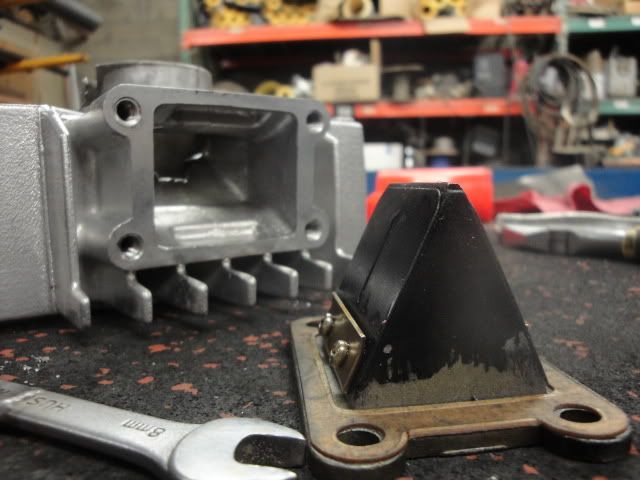

Rich made one; he's got a photo of it, but so far he won't sell it to me - it's his prototype and he won't part with it.
I guess i'll have to wait, though it could be an eternally long wait.
Maybe someone else can have a go at making a viable reed valve intake system.
Fabian
dude has no welder, it was painted, probably to hide the jbweld

You can place a reed valve in the intake, it doesn't have to be part of the jug itself.. Any reed is better than none.. Example: I had a 74 elsinore 125 honda.. A Piston port motor from the factory, if any of you can remember those bikes, they were blazing fast super screamers..But installed a (GP kit), which consisted of a 4petal reed cage in an intake manifold (common terminology) between the carb and intake port.. It works, lol! Widened the power band and gave a little more on top to boot! REED, IS GOOD!
