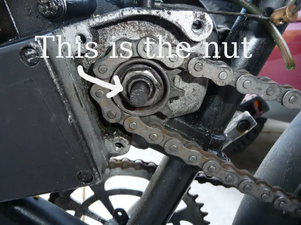

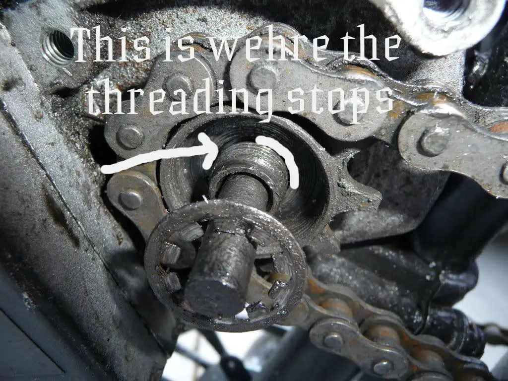

The next morning is my issue. I went to go see if the overheating damaged anything and this is where I am at. When I pedal to get momentum to turn over the engine, everything is smooth until i engage the clutch. What happens is, my rear tire completely stops rotating and I skid until I stop. I took off the clutch plate and looked at the sprocket. I was unable to turn the nut connected to it to the point where it rotates the whole gear along with the chain as you have to do to get the chain on. I went to tighten the nut and it just keeps spinning due to the limited thread...HELP! what's going on!?!?!? the clutch sprocket doesn't rotate at all!

I defiantly didn't strip the bolt that the nut screws onto... I can see that there is just limited threading to work with and its almost as if the washer isn't thick enough? because when I tighten it down, it surpasses the threading and then rotates freely.

the only issue I have is that the external sprocket that the chain is resting on does not rotate when the clutch is engaged. Normally, and prior to this incident, the nature of the sprocket was so that you could manually rotate it with a spark plug wrench. This is also the same method used to initially get the chain around the sprocket before you connect the master link. Now, when I try to engage it after pedaling or by manually turning it with the spark plug wrench, it doesn't rotate. When I hold the clutch lever down and the clutch is not activated, the entire system rotates freely and functionally which is how I am able to pedal around still.

I am uploading pics right now, the *drive sprocket will not rotate when the clutch lever is engaged and the *m14 nut is the nut that continually rotates when I try and tighten it down.

I'm waiting for the pics, but I am still guessing you stripped the nut trying to tighten it due to the whole works being locked up solid.

If the key is stripped, and the chain installed the shaft will turn but the sprocket won't. Try adding another washer if the key is intact. Check threads in the nut.
To tighten the nut, remove the clutch cover, wedge a penny between the two gears and tighten the sprocket nut.
