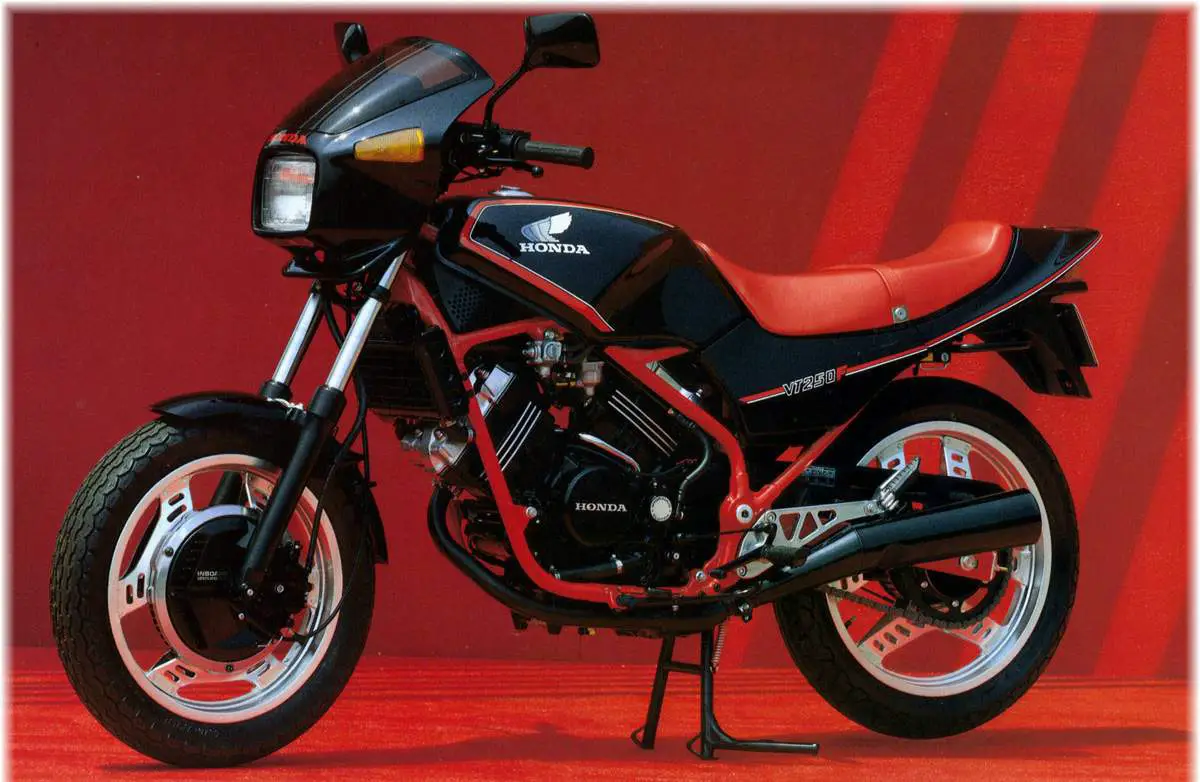

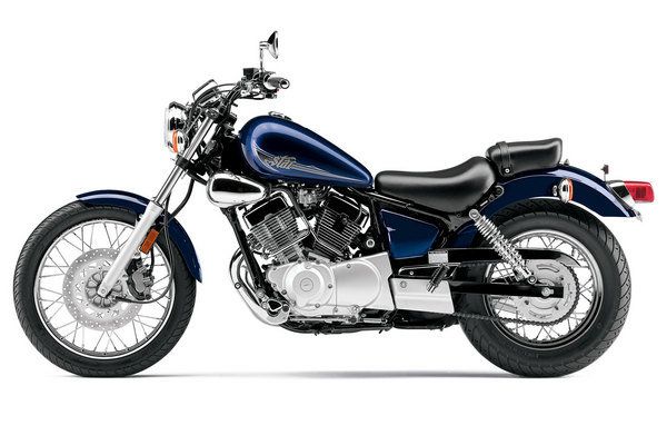

Motorcycle with integrated transmission & air cooled engine. Nothing against the industrial engines. I'm actually a fan. My thinking on the Copper Gator carries over to this V-twin build. I have a target weight & 100 lbs. is about it for engine and transmission. Industrial motor alone will use that up without clutch and transmission. I have a new 5 speed Harley Davidson transmission sitting on the shelf, but couple that to 600 cc Briggs and I'd have a quite large and heavy package. Integrated V-twin makes a clean package with small footprint & ends up costing me less in install time, setup and dollars. More bang out of the box from fewer cubic inches as well. Big torque from the industrial motor is more than offset by 5 speeds and hi rpm horsepower from the factory. I'll bolt on some horsepower as well but won't break the bank getting to 30 hp that's for sure & I also have a multi certified factory mechanic (Honda & Kawasaki) on the payroll who already gets paid for drinking coffee and talking racing. I haven't decided on a specific motor but 250 cc to 500 cc are reasonable parameters to start with. Keeping the weight well under 200 lbs. total is a design goal as well, so displacement choices are somewhat self limiting. I'm not worried about frame strength, just really like light and lively bikes! Rick C.
This bike will have to run all the state dictated safety & regulatory items, so the factory motorcycle wiring harness is also good to have & saves a little time that I'd really rather spend on doing the fun stuff. I really hate electrical!!
Ludwig II
Jul 17, 2012
5,071
783
UK
My immediate thought is Chinese made Yamaha Virago 250. Chain drive. There are 125 twins from Honda and Yamaha as well. Thre must be a Honda 250, but would it be a sleeved and destroked 400? Interesting.
indian22
Dec 31, 2014
4,725
7,711
Oklahoma
Decisions, decisions! Ludwig thanks for the inspiring variety of Vee's little water cooled Shadow is quite nice & makes me rethink my air cooled only stance. I'm liking the Virago as well, but the Morini is sooo sweet in such a tiny package.
The Texas/ Oklahoma area is swamped with good used bikes and parts so prices are typically low compared to many other areas, so I'm always on the lookout for donor bikes.
I'll post up photos of a side by side go-cart we are hacking together for the boys to play with...250cc 5 speed vertical twin...seriously modified for power! Sold one recently powered by a Honda Gull wing set up...talk about fast! Definitely not a kids toy, but with paddle tires it tore up the sand dunes at "Little Sahara" just north of us.
The V twin project needs a cradle so I'm searching now for a Simplex frame to cut up. Trust me it won't look anything like my "Simplex Copper Gator" when completed. The heritage will be recognizable as a Simplex sort of but unique. I really don't like to copy even my own work. With what I've got going on with other projects I'm realistically looking at about a year to completion, if I can get started on the frame & engine quickly next Spring I'll have my Simplex V-twin to the point my "Copper Gator" is now.
