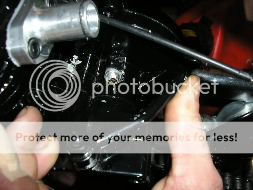

when clutch is engaged the arm on motor is usually in line with the cover pointing straight back twords rear wheel pic #1 pic #2 is dis engaged lever twords the clutch cover hope this helps and if motor is brand new with clutch disengaged sometimes sprocket wont spin use a flatblade scredriver and turn the sprocket at bottom using case for leverage they are 90% of the time imposible to spin with fingers when brand new
