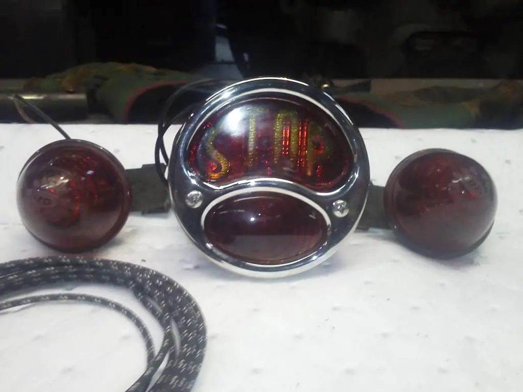

And I found a tail light, its a re-pro but still cool and was only $24, Can't beat that with a stick.

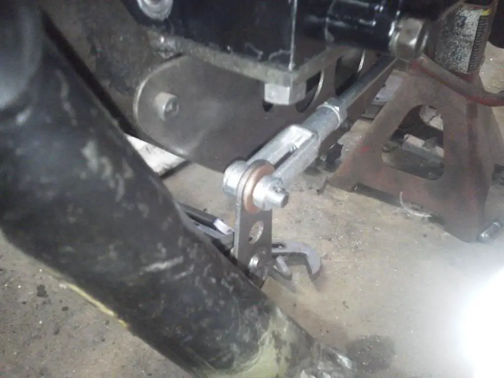

And back to the brakes, finished up the mounts and linkage from the brake lever to the back wheel.
Might swap the clip on the end of the brake rod for a yoke an clevis-pin like the one up the front. That was the last one in the shop and ace was out as well. On the other hand I bet I could machine one out of stainless in the time it would take to get to Tractor Supply an back.

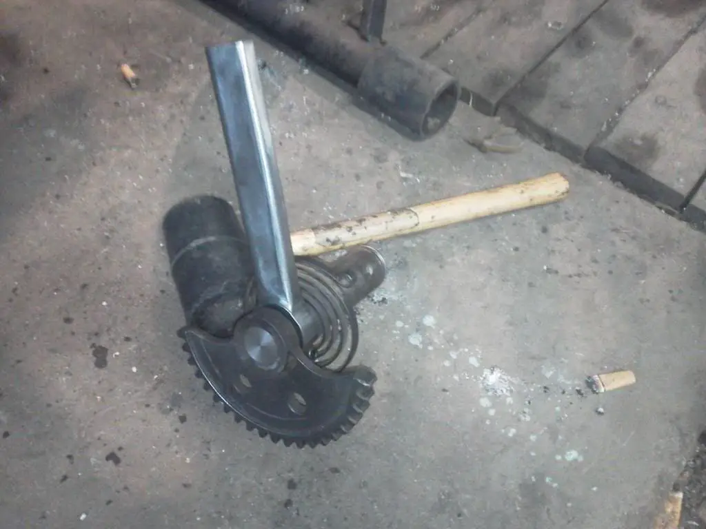

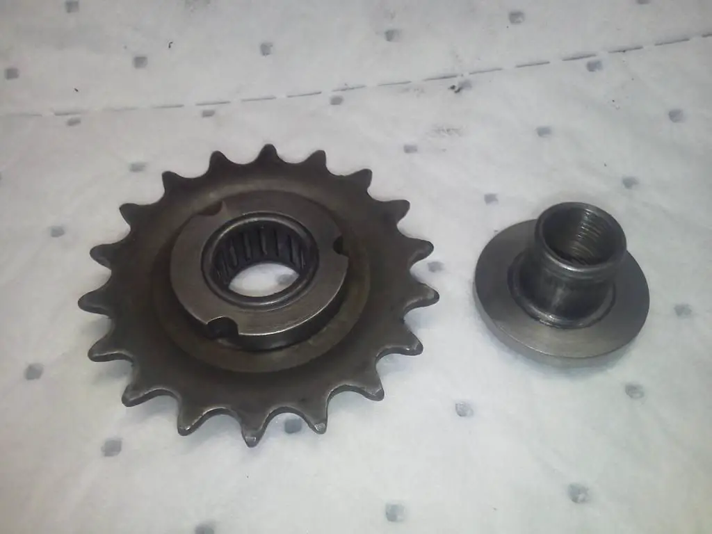

Did some work on the kick-start as well, not so much changing as up grading parts and or materials. Like the axle was a cut down 3/4" bolt which are never really 3/4", there like .738 which is a little more slop then I like. So I turned one down out of stainless and stepped it 1" for the gear,7/8" arm and spring and .749 for the bronze bearings.

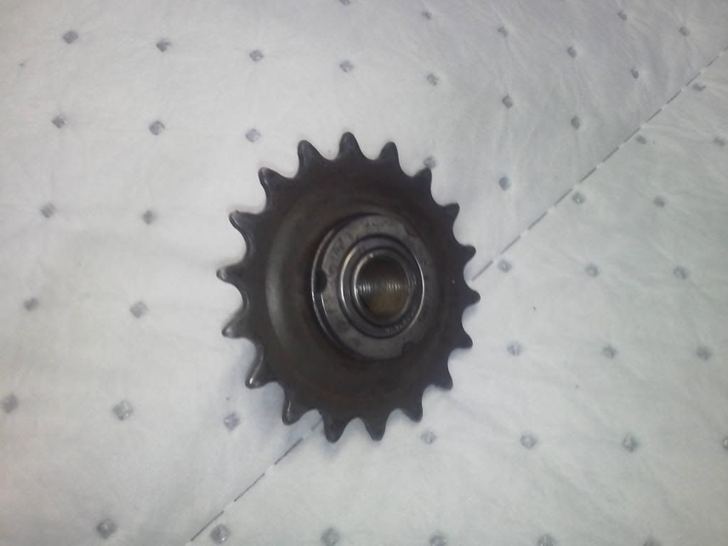

Couldn't remember if I ever showed any photos of the hub I made for sprocket on the flywheel side of the kick-start.
That's a one way clutch needle bearing pressed in there. Took two tries to get that right, if you find your self using them make sure you check the +/- tolerances.
And last my tail-light and wire showed up and I came across some marker lights as well so I'll be back on the electrical side of thing soon. With any luck I'll have the alternator figured out by then.

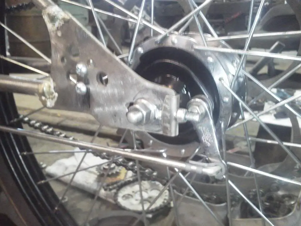

Looking at what I expect is a way to tighten the wheel axle back in the drop outs, I was wondering how the parts push or pull to make the chain tighter?
I guess I just may not be seeing where the threaded rod by what looks like maybe a nylon locking nut move toward the back of the drop outs with something attached to the threaded rod. Something then would have to encompass the axle attached to the threaded rod to pull back and tighten the wheel if I got it right? Is that a washer that is welded to the rod?

That's all they are. Came off a BMX or maybe a track bike, I did make new ends that fold over the frame. The ones that they came with were kind'a week.

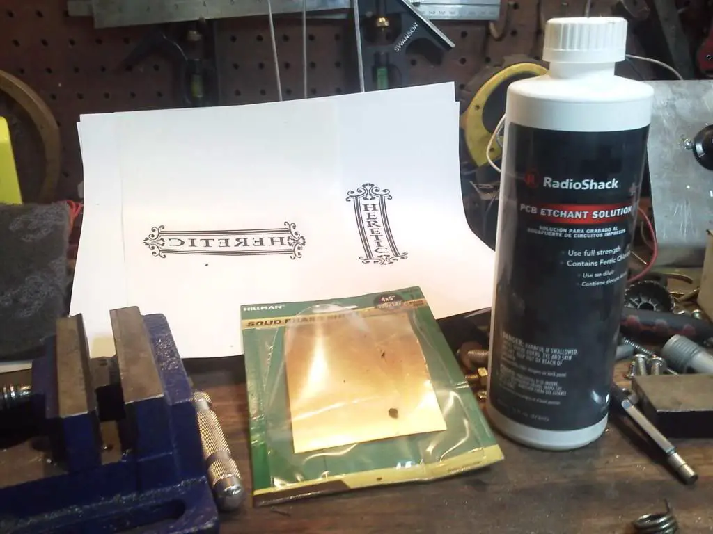

I,ve realized I don't make parts in a very productive order. I make things in the order that are the most inspiring . So to that end ......The head badge.
Brass, ferric acid(PC board etching) and a little photoshop
Aged over ammonia and a little sanding for contrast.
