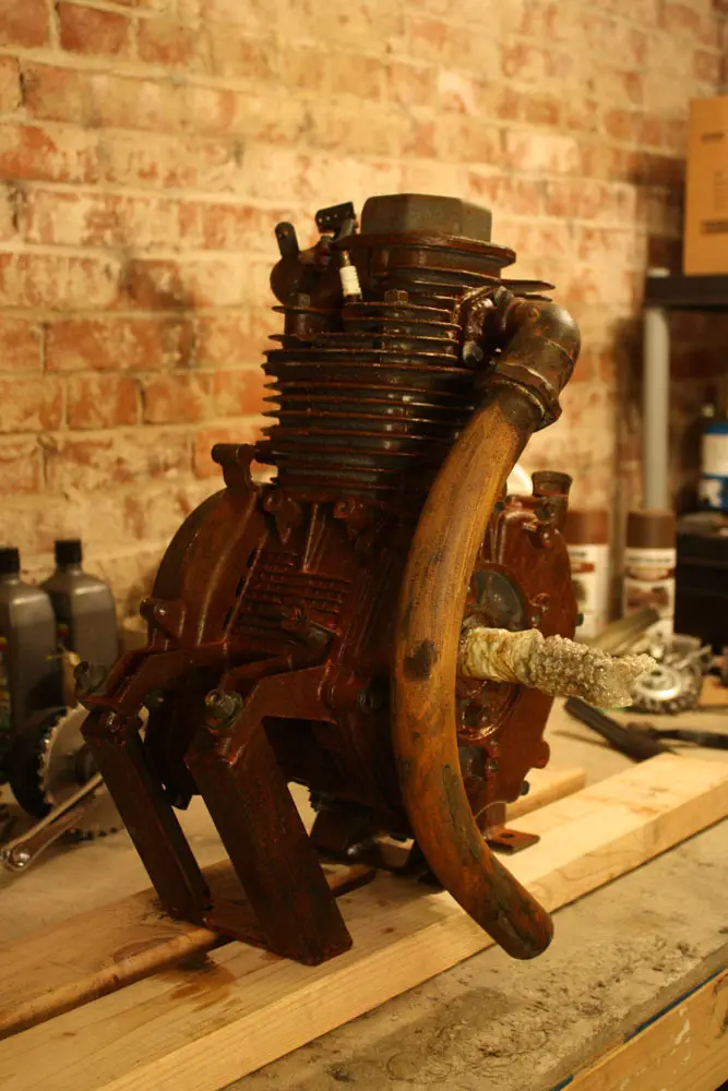

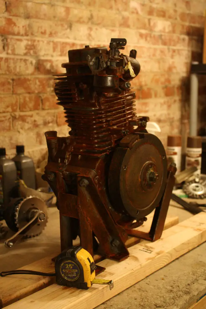

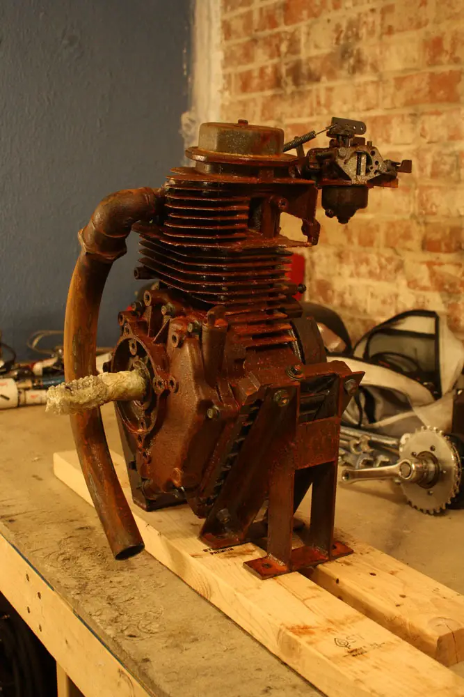

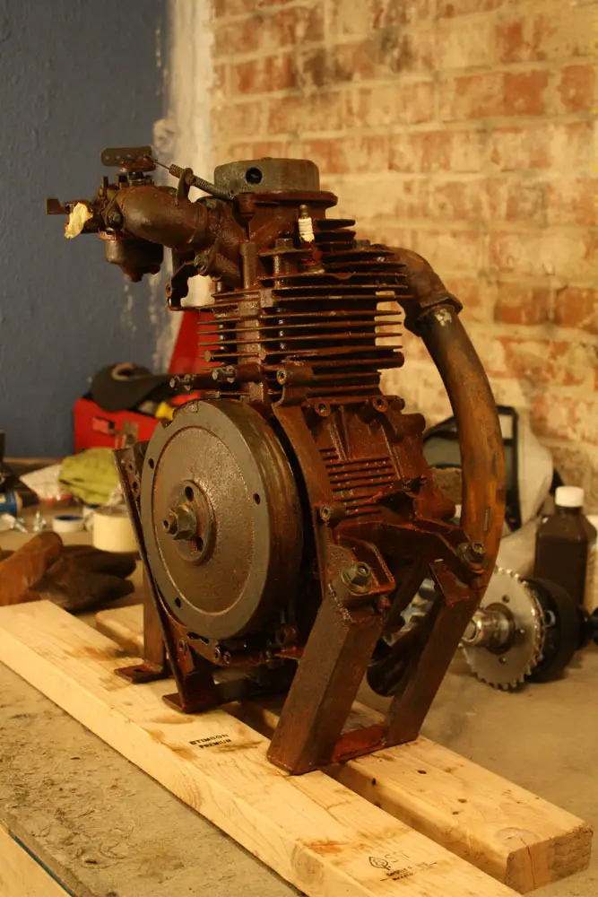

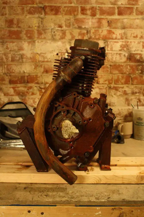

Making some progress on the 400 racer. I spent the last week stripping the engine and fabricating the engine mount, and aging the engine. The goal for this bike is to make it look 100+ years old, like grandpa forgot he had it behind the barn. I was very inspired by Mr.B's Excalibur build that I knew I had to do something different. I spent so much time making sure my last bike was perfect in the smallest details that I need a change of pace. Also with this being a prototype I want to have the ability to modify things and not worry about having to repaint things. But just to reassure you all quality will not be sacrificed I just want a bike I'm less protective of.
The engine is mostly cast aluminum with a living patina on it, made out of iron oxide paint and various chemicals. This means it will only get better looking, more weathered, and realistic with time.
I almost for got to mention that the front of the frame will run through the forked part on the front of the engine. this will keep everything very compact and balanced.

That engine looks so old I hardly recognize it. If you ever sell the completed bike someone may actually "restore" it. You know, strip it all down, clean it up, and give it a fresh paint job! Seriously, though, I am sure it's going to look 100 years old when your done. Very cool!

Looks totally awesome Lurker, can I make a suggestion though, if you haven't already planned to do so? I think your engine would look even better with a faux head cover. Im playing around with a similar setup on my GX160. I'm on my phone so can't post a link but if you watch the YouTube video "Dixie Flyer board track racer" you will see the round aluminium pieces that make up the faux head.
Could you share the technique that got your engine looking so damn nice, it would be appreciated.

"New patina" taken to a new level. I honestly thought that engine was something you found at an auction or in the stationary engines catagory on Ebay until bout the 3rd pic. Really nice work. Care to share the formula ?
MHF

I have 2 main goals with this bike, quick build time and as little money invested as I can. I have had people tell me to make a successful business you need to make double what you put in to it. With that being said I need to keep cost and time down, and so far so good.
The bike construction is made up of 4 stages
1. The transmission
2. Engine mount fabrication
3. Fram modification
4. Gas tank construction.
I only have about 30 hrs invested in fabrication time currently, and I'm half done on my check list so I think I'm doing pretty good so far.
When I started this project I was hoping to have it completed in 3 months tops, but due to an opportunity of a lifetime I will be going to Japan In a few months, so my budget for this build is currently $0.00.
As for the patina here is a link to everything you need
http://www.sculptnouveau.com/index.cfm
If you search sculptnoueau on youtube there are a few demo videos. It's easier to watch than explain.

How well will this finish hold up to heat?

dracothered, the finish should hold up fine, it is a very durable pant. I fired her up for the first time to day and let it run for a few min. and the patina still looks good. The neat thing about this patina is that the crappier it looks the better and more realistic it looks. Obviously you would not apply the iron oxide paint to the exhaust manifold, however you do want to apply the chemicals that create the rust.
