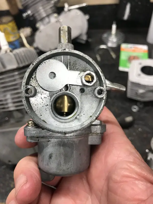

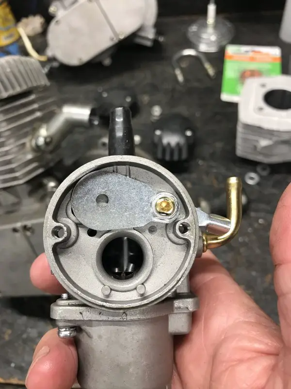

Here’s a couple of pictures of a nt carb with the brass slide and a Bofang carb with the black slide. Both are set at idle height.
thankss for those reference pics bro :) my carb is very similar. ill check and compare to see whats going on
