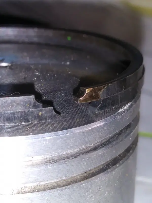

Took it out last night it would not start till I checked for spark as I was trying to start it yep it had spark then it started to fire and it finally lit off, the choke is so annoying on my carb I have to get off bike fumble around to pull it up and most of the time I do not need it. Strange, when I first bought carb with larger jetting the choke would work like normal then after time the engine would lite off without choke, then I leaned out the pilot and main and normally starts without choke. From what I read if a Dellorto starts fine no choke you can go leaner on pilot jetting. anyway got the bike running and it sputtered coughed backfired most of the ride about 15 miles round trip, had to slip clutch to keep it going must of got water in the gas tank or pilot jet got trash in it. Everyday something new with motorized bicycle. been a real bad 3 weeks for me. Least I have plants growing food at home I scavange. picture shows root cause of loss of power after about 2500 miles worth.
