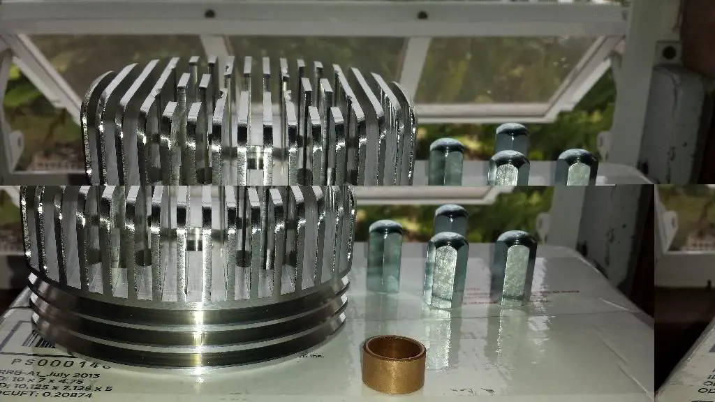

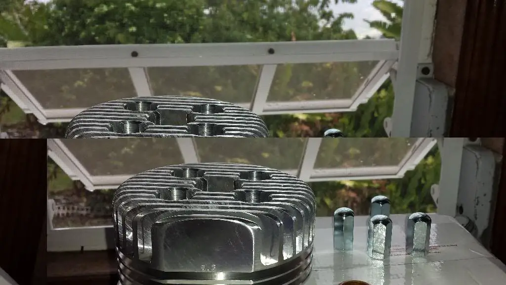

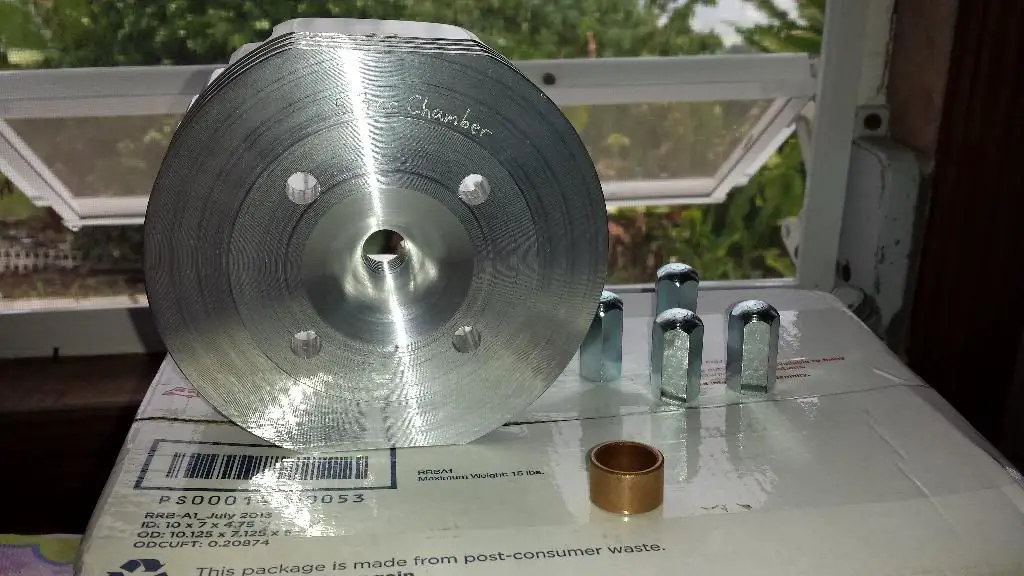

going case inducted!!!
mech_engineer
Mar 3, 2014
175
Puerto Rico
I am going to use 100 octane and blendzall
All the cdi components
The small bearing is the lower rod bearing i need to do more research about the oil filled bearing before install it on the crank
