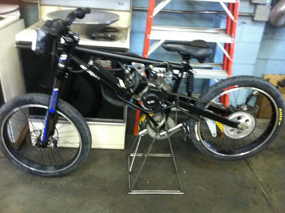

ok after your response to me on the forks question, I have retraced the thread, and this photo is where those shock forks show up, with no mention. what are they and how stiff and how much $? I'm still debating shocks, or springer. the weight thing has me leaning toward shocks. but what are yours? are they Judys?
scotto-
Custom 4-Stroke Bike Builder
Jun 3, 2010
6,505
24
38
Ridin' inSane Diego, CA.
These forks are SR Suntour XCR (011 Series) and they are stiff enough with adjustable pre-load and can be locked out for when you want them rigid. They were $114 online and are a really good fork for the money.
