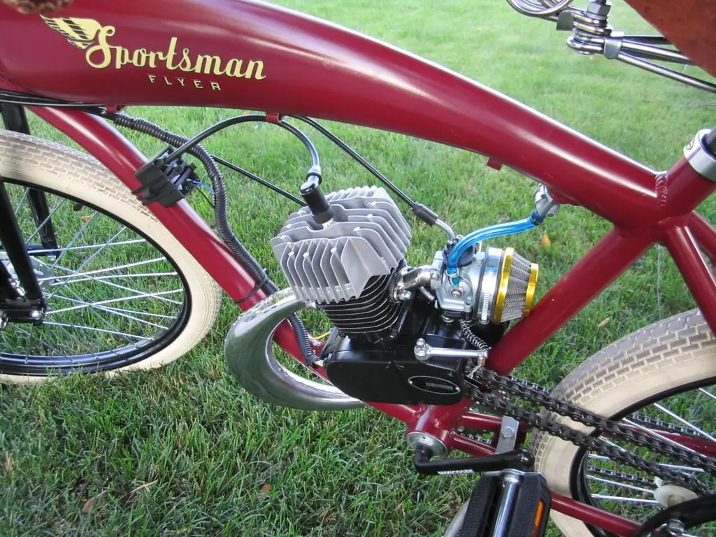

Well I figured out what the problem was, When working with China Murphys law is always prevalent. Actually it was an oversight on my part. The Dax Head has a deep socket for the bolts so I purchased some deep socket cap nuts (with blind taps) for mounting. They tightened the head down but were bottoming out the studs before I could get the need torque. So just adding some extra washers worked, Fired right up. Soooo Here is my take on my add-ons :
RT Carb (replaced CNS) : starts and idles much better. Also enhanced performance some. Ill give it a score of 8.
Banana exhaust pipe: Enhanced performance a little and is a little louder. Give it a 6
Dax High Compression Head: Noticeable torque increase in low and mid RPM’s and head runs much cooler. Give it a 10 (very good bang for the buck)
I’m sure there are other mods out there that work as well or better (or worse) but I just wanted to give my impression on what I have added.

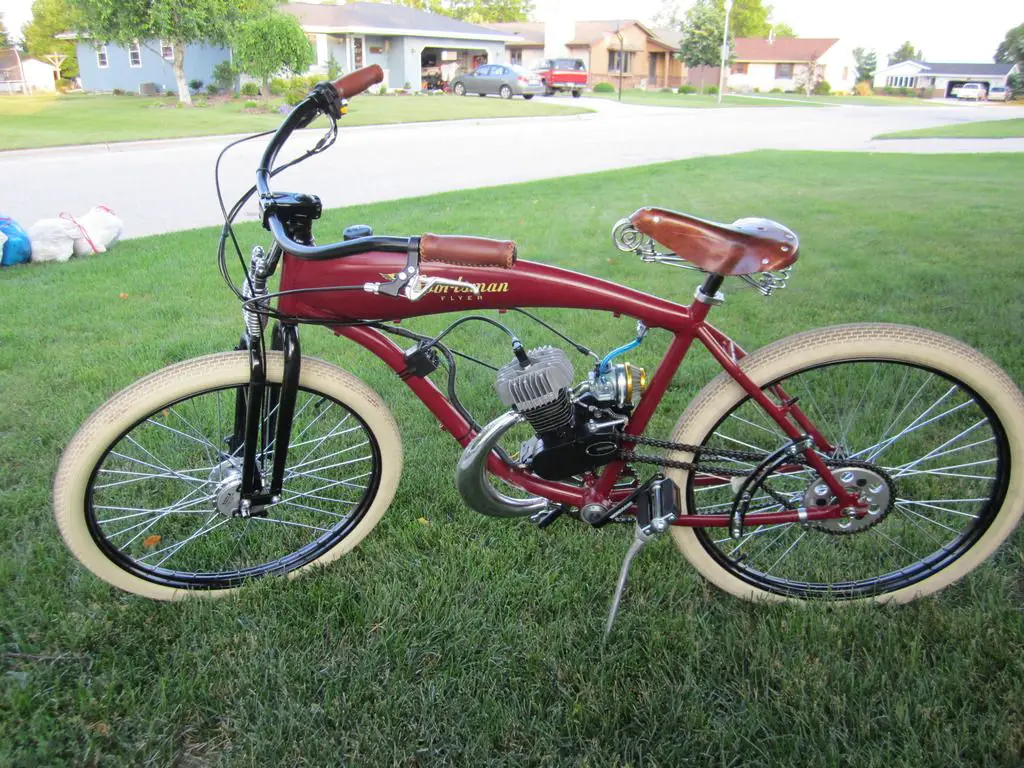

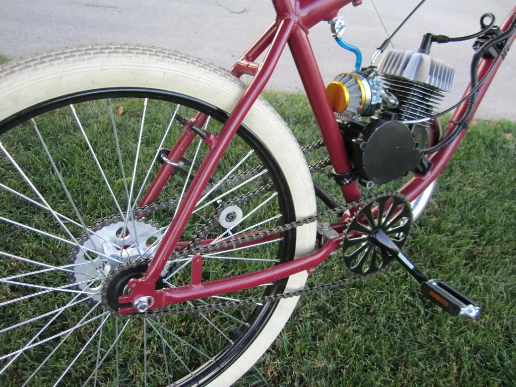

some pics
(Re these pics ok or do I deed to downsize ?)
