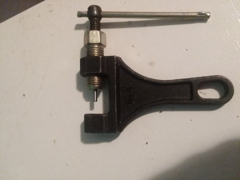

You also want a very good bicycle chain. I like the SRAM 870 or the KMC 899X. You should also carry with you a quality chain breaker tool and Quik Links. Don't get one of those pieces of junk breakers from Wal-Mart. I got a motorcycle grade chain breaker off eBay for $10. You'll have to file down the push pin so it'll fit through a bicycle chain plates and roller.

You also want a very good bicycle chain. I like the SRAM 870 or the KMC 899X. You should also carry with you a quality chain breaker tool and Quik Links. Don't get one of those pieces of junk breakers from Wal-Mart. I got a motorcycle grade chain breaker off eBay for $10. You'll have to file down the push pin so it'll fit through a bicycle chain plates and roller. View attachment 105516
you read my mind!!!! I was taking a peak at these to throw in my bag that i'll take with me anytime I ride. I appreciate the heads up on just getting a heavy duty one for motorcycles and modifying it slightly.
thank you also for this recommendation: SRAM 870 or the KMC 899X - I will absolutely be investing in 2x heavy duty chains (1x to toss in my bag)!

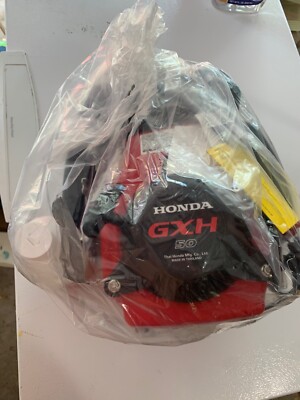

Yes, It is expensive, but in the long run, your ahead of the game. You might beable to pick that Honda GXH50 up for cheap because they now have the new GX50's out.
Thank you for the recommendation my friend :). I was considering 4 stroke if I wanted to "go all out" and burn some holes in the pocket, lol. Ultimately I would love to have 4 stroke with the shift kit, but I think I honestly will end up doing that later down the road. I think due to simplicity sake and due to what i'm familiar with/comfortable with + affordable if i toast it- i'll probably stick with an affordable 80cc 2 stroke. Trust me, I want to rock the 4 stroke for many reasons, but overall I can build the 2x really cute setups for my wife and i for the price of 1 fully setup 4 stroke (almost). We are both light/small riders, so it should work!
