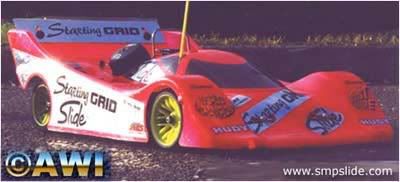

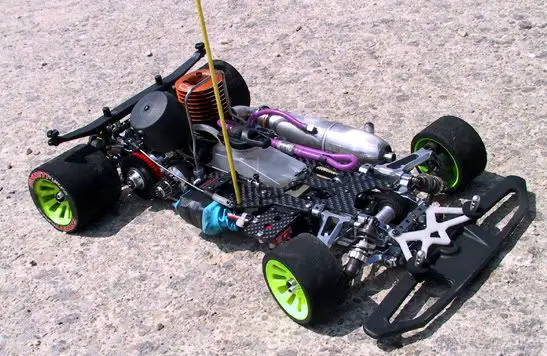

I was heavily into Nitro R/C car racing for many years; 1/8 scale ON ROAD cars, (over 80MPH!)
Where some of the ideas work on these HT engines, the simple fact is that those R/C engines were built to handle nitro fuel & very high RPMs (over 48,000 RPMS)... these HT engines aren't! :(
Here's some pics of the kind of cars I raced... 'SMP Slide'.
