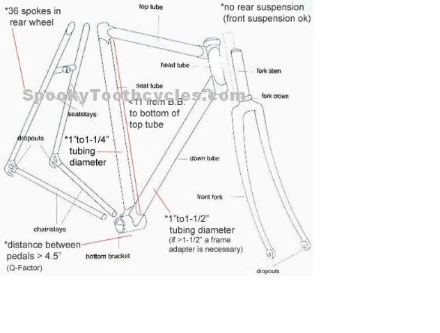

Welcome keysertomasi,
For the in frame two-stroke...
Most 24" or 26" bicycle with diamond frame and horizontal top tube should have sufficient space to mount motor.
At least 12.5 inches running along the seat tube from the top of the bottom bracket to the bottom of the top tube.Tubing size from 1-1.5inches on the both the seat and down tube. Plus or minus 70deg. above the bottom bracket between the down tube and the seat tube. Inner distance between pedals needs to be greater than 4.5 inches in width to clear the 4.5inch wide motor.
http://motorbicycling.com/f3/what-ki...mmend-510.html

thank you all so much for your quick and comprehensive replies. Let me try to answer each of your questions in turn:
BAMFinCali - I am looking for a two-stroke, in-frame motor. I'm in a state where the motor size must be less than 50cc, so one of the 48-49cc kits would be best for me.
fairracing31 - Yes, I've heard about 24" - 26" frames.... the only thing I don't understand, is what dimension of the frame is 24" to 26"? In response to your mention of the various lengths, the lenght of the seat tube inside the frame, from the inside (or bottom) of the top tube, to above where it meets the inside of the other tube is a but more than 13". All three tubes in the triangle part of the fram have diameters between 1-1/8" to 1-1/4". The angle between the seat tube and down tube is something I can not measure right now without a protractor or other proper tool. The width between the pedals at the narrowest point is about 4-3/8".

24 and 26" is the wheel and bike size not the frame size. anything over 12 1/2" for the bike frame tube should be fine.(thats the part from the top of peddal/crank area to the bottom of top tube)
