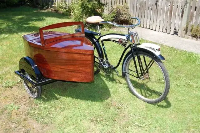

Here is where the motor is going. Click on the photo to enlarge it.
I think the Cadillac should have the best and the 1200w/48v Currie will provide it. Shame to keep a good bike down.
