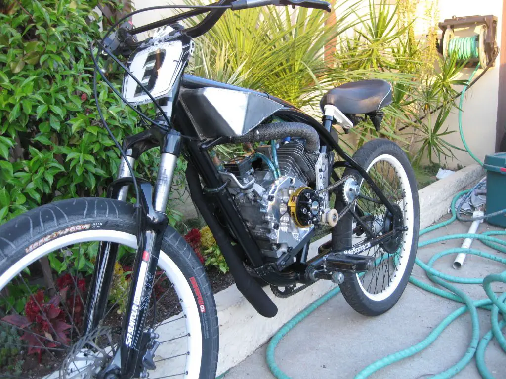

Or you can build a little 49cc 4-stroke like I ride daily and cruise 30-35mph all day long, everyday.
Or build a monster 212cc bike like I race a go whatever speed you like.....40, 50, 60 or even 70mph. Not recommended for street use though lol.
49cc 4-Stroke
212cc 4-Stroke
