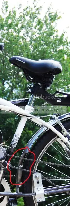

I'm hitting snags on just about every part of my build but so far have been able to overcome them. Well, my discovery today is major and may just put a stop to my hole build. Please help ... I'm building an old schwinn 60's era bike. Everything on this dang thing is just non-standard it seems.
My big issue #1 for today is that the cranks don't clear the motor! I need about another 1/4" at least between my cranks so they clear the engine.
So ok, can I somehow bend these things out a little bit without screwing them up? Anyone else had to do this? I was thinking about taking them off, putting them in a vice and using a pipe to slightly bend each side out what do you think?
And issue #2 is that the motor does not clear the chain guard. I can't get the motor low enough to mount the frame because the chainguard is in the way. So no big deal except that my chainguard is amazingly beautiful! I don;t want to do without it. Its nice shiny chrome schwinn chainguard and I really like it. So I will try to figure this one out too but first the dang cranks?
Any suggestions very very appreciated!

Well, I must say I jumped the gun on this post. Sorry about that, I'm a noob and I actually thought this thing would simply bolt on and I would be motoring down the road. Thanks for your suggestions and for not giving me the reminder I deserve to actually read or search the forums first.
So anyway, the motor is one of those 49cc chinese deals from eBay listed as 80cc. I think I am going to go ahead and buy a new crank since the sprocket on my old schwinn crank is a bit bent anyway. hopefully I won't have any issues with getting a modern one that fits the bb.
As far as the motor mount, after I posted this I searched around these forums ... shame on me should of done that first. I am leaning towards a simple "L" bracket with a muffler clamp turned on its side. Personally, I think simple is good and mainly this setup offers all kinds of adjustment.
Funny thing is, I work for a huge OEM and we have custom brackets all over the shop. These things are usually made out of 1/4" steel and heat treated ;)
I'm sure we have a few scraps. I am going to see if I can find something that will fit ... simply just need one thats about 4" long and about 2 1/4" wide. I'll drill it at time of mount to get it at the optimized position.
I'm also going to paint it to match my bikes new paint job so it will look good too. So, yeah, uhm, I feel pretty silly right about now. Sorry about this post!

Really good information here and suggestions ... very appreciated. I'm a little confused about the cranks though. Almost all sites I checked out only spec the crank arm length and say nothing about the width between them or the threads. Also I am a little worried about them fitting in my old schwinn BB.
I measured the width of the motor and it seems that I need at least 5 1/4" between my crank arms and that would be cutting it close. 5 1/2" would be ideal I think.
MapBike, thanks for the links ... do you happen to know how much clearance are between those crank arms? Also, is a 36T sprocket pretty much standard since I left mine at the shop and can't count them now. Also, those dang twisted chrome sets are way tempting. Is it just me or what but it seems that there are no threads on those cranks?
As a back-up, I brought my crank to work today and our pipe fitter is going to bend them up for me. He's going to heat them up and do it right. These guys do amazing things with some of the special machines we build so I am confident they will be great when hes done. Should be done tomorrow. Only thing is I'm not too happy about having shorter cranks and not sure how its going to look. You never know ... maybe be kind of cool cause they will be unique. But if they turn out ugly I'm ordering that 6" flat twist set ;)
Also, I sketched up a bracket for the front mount and started working on it at the shop today. Its going to be awesome and will be done tomorrow. I'll post some pics when I can.

My cranks got put on hold today since I was just too swamped at the office today to deal with it. Should have my front motor mount and cranks done tomorrow though if all goes well. I do hope they work cause I like my old school schwinn pedals also. They are not 1/2" but I think 7/16" instead. I spent and hour or so cleaning them and they look pretty damn good on the bike and so does the stock sprocket. Its the signature schwinn sprocket that everyone recognizes.
I almost forgot about my coaster arm so I'm taking that in to bend also. I put the rear sprocket on today ... well kind of. It was a major pain in the a$$! All went well except one of the cheapo bolts that came in the kit has messed up threads in one spot. So need to replace that.
I don't think I'm going to be able to get the sprocket perfect like I want it without spending another few hours on it. It will have just a very slight side to side wobble and up down. I'm going to get it the best I can and see how it goes. I already spent 3 hours on it and its somewhat close. At least not wobbling all over the place.
Hoping I don't have to chop the rear fender for chain clearance but we'll see when I get the motor mounted. Wondering what you guys use for chopping down chrome fenders? I don't have much for tools here at home but was thinking a hack saw or my cheap chinese non UL listed angle grinder might do the job.
Oh yeah .... and kind of wierd .... I counted the sprocket teeth today and it has more then 44 ... not exactly sure but I counted twice and swear there is like 49 or something.

1. You can try and bend them, but they may just break.
Wide Cranks - Wide Crank Pedal Kit
2. I had to take off my beautiful schwinn chain guard as well. It sucks. But it looks good now with both chains anyway.
DON'T try and mount your motor higher just for the chain guard. I tried this by lengthening the studs, and this is a bad idea. It causes problems, and it's not safe.
I had to. Just sayin.
Don't use a hacksaw. That will screw it up. Draw the cuts with a sharpie and cut with a dremel and discs. It may take up to 10 discs but it will work. You can see where I cut for clearance. Then sand it. I used 60 grit then 400 to give it a nicer finish. You can go 600 grit after that if it bothers you.
