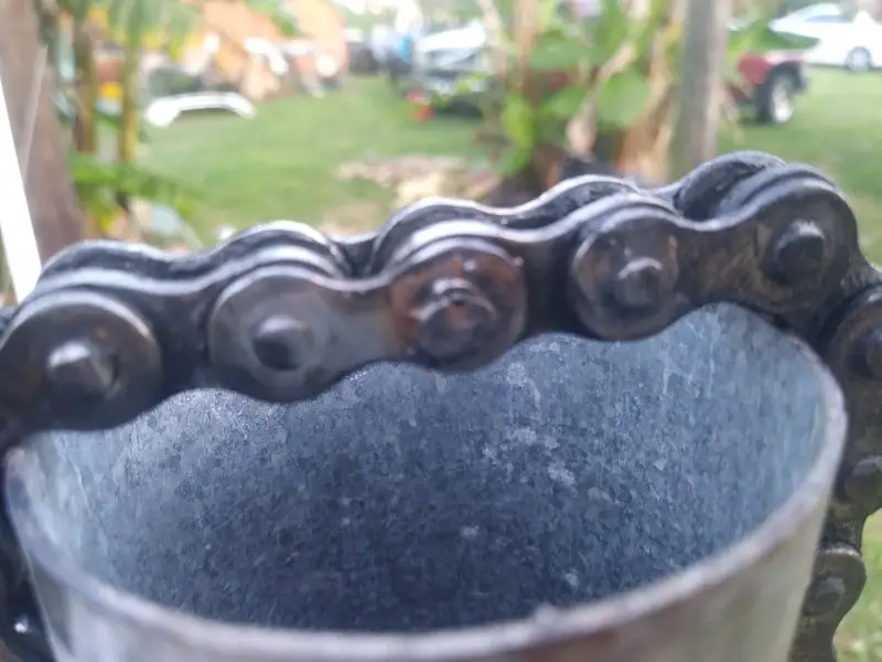

I welded all my 415 chains cause the link did not last 5 miles so I weld em all now. I ditched the 415h chains now trying out the 420 chain seems better so far. the 415 chains last about 1000 miles time for new.

I welded all my 415 chains cause the link did not last 5 miles so I weld em all now. I ditched the 415h chains now trying out the 420 chain seems better so far. the 415 chains last about 1000 miles time for new. View attachment 101132 View attachment 101132
It may fail there. Chains are made of hardened steel. Welding on it weakens it. Run the master link that comes with it and make sure the closed end is leading. Athough, I have done that on half links, and it was better than a cotter pin but after enough trouble I stopped using half links.

Don’t get the 41, that stuff is ****. Go to your local motorcycle apparel shop and get 420 chain. There is usually a $20 and a $30 420, the $20 one works great for 212. Don’t lube it. Don’t clean it either. Just run as is. I put about 20k miles on 212s. I seen everything.
