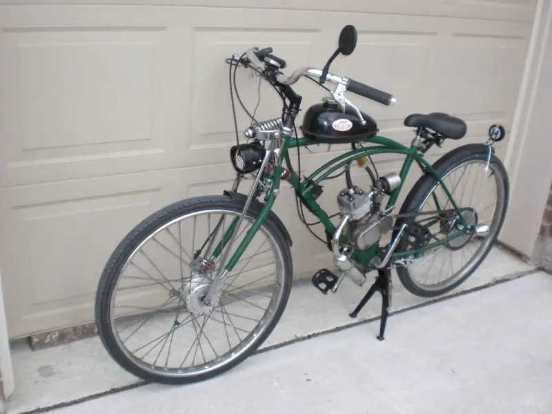

I used the cantilever style Springer and it worked well on the bumpy roads. They are way under 100 bucks on Ebay.
You could also look for a used mountain bike fork. Most are very durable.

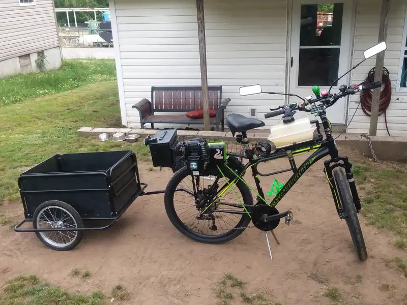

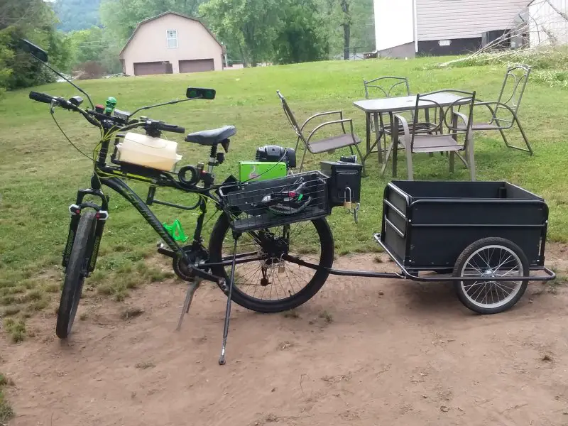

I've found my Schwinn Sidewinder to be very comfortable I also added a suspension seat post. The bike new from Wal-Mart is around a total of $225. It was only ment for someone 5'10" and I'm 6'2". Therefore I did raise the handlebar height to where I ride in an upright position.
