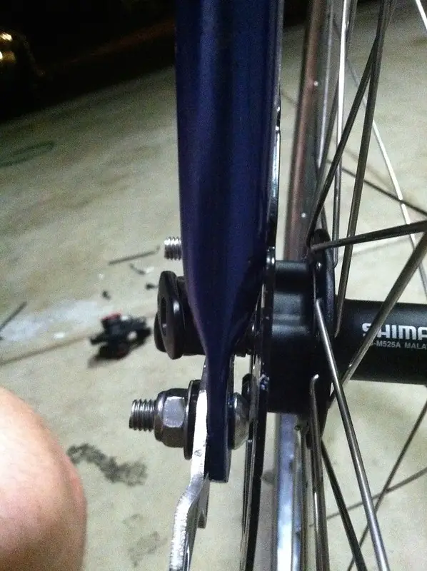

I started to assemble the bike after painting it, and I've run into some issues here.

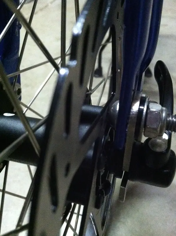

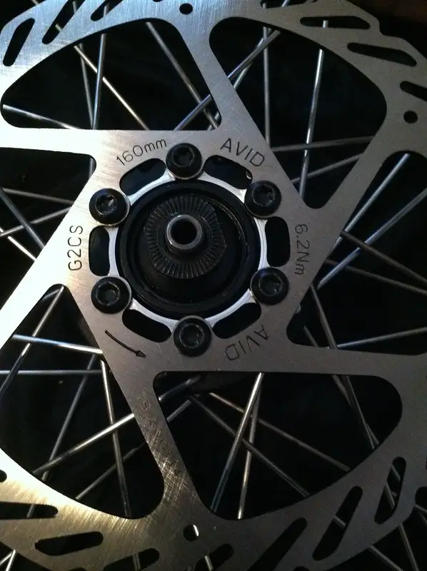

The rotor is touching the fork, so much that the wheel won't even spin. The bolts for the dropouts also touch the rotor. Not quiet sure why this is. I'm using the same hub VMB sells with the fork. I'm also using a 160mm disk.
Not sure what to do at this point. Any suggestions?

Looking at pictures I think I just need to put the drop outs on the inside instead of the outside. I'm going to try that and see how fits tomorrow.

Yes!! Switch the dropouts to the inside of the fork legs.
Also... make sure that when you tighten the bolts, that you leave them about 1/8 turn loose so the dropouts can still move with the spring action. ;)
You can also just call me if you have any other questions about the fork. :)
