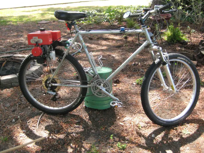

I Got This Engine "K&S BIKE MACHINE" in 1983 from Coombs Liquidation "paper" catalog. I bought 2, one I lost in a flood this one stayed in a box till the box disintegrated and is N.O.S. missing some parts, but it works That's the long. Now that I'm 71, I modified my 1983 stump jumper with a suspension fork and added the K&S Bike Machine engine which I modified by removing condenser and points and adding a Solid State Ignition also modified exhaust by removing muffler and replacing it with Poulan Wild Thing Chainsaw exhaust baffle and spark arrester. It topped out at 31 MPH, before Mod, 27 MPH.
People ask me Why? and about the bike and I say. " I got the engine in 83 because I knew one day I Be old and would need it to ride" The real reason is $4.25 GAS. I get 15 Mi. per tank and tank is small.
