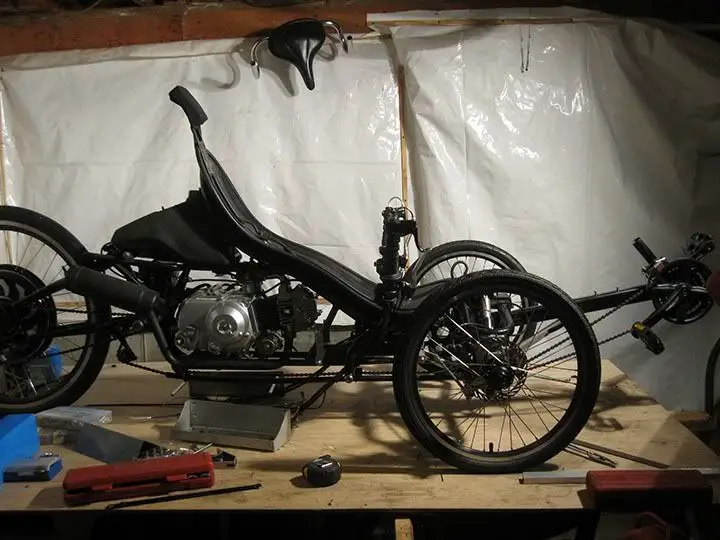

Here's a few shots of the tray details, doesn't seem like much to fret over - but aside from my lil vacation, the reason they were a bit of a challenge becomes more clear as you can see in the pics it's a busy place w/o much room for location choices or error... in the last pic I've got the larger SLAs in place tho I'm obviously not going to use them unless the lifepo4 packs fail for w/e reason;

I'd weighed the individual components a while ago & it was about 126 pounds total, minus only little things I didn't have at the time such as the throttles, switches & wiring... so mebbe 130lbs? Seems like a lot I know - but on the other hand it's almost exactly the same weight as a new moped, less than many even :D
minus engines & batteries 49lbs
engines (both) 60lbs
lifepo4 packs 16.5lbs
The kicker was replacing the SLA batteries, which just by themselves weighed 34lbs... yet with roughly 1/2 the capacity of the lifepos >.<

...and I did manage to get some "work" done as well heh
The handlebars I'd made before weren't supposed to be just "mock ups" but they were jus' a lil wonky - as it turns out the left one was turned in just a tiny bit, which drove me nuts for a lil while trying to figure out why my seat could be perfectly centered... but not centered at the same time o_O I coulda fixed them I s'pose as they were still only tack welded, but I woulda hadta redo the fishmouth & they were already a lil too short, so I jus' made new ones.
What's interesting is while I'm not completely satisfied with the angle/shape, they're comfy enough and as the only other sacrificial handlebar candidate I had that was even remotely close to what I need was exactly the same as the first one I hacked up - I guess it's fate lol
Still a hair short I stuck 2" extensions on 'em too, which prolly makes them a tiny bit too tall now, but as it's far easier to trim them down than to extend them again I'll try 'em as is and see how they feel. Everything still clears at maximum turn so it's just a matter of ergonomics... or me being a picky SOB... six of one/half dozen of the other really I s'pose;
....and I'm outa semigloss black paint again aargh >.<

Got the new handlebars (temp) painted & installed & did summore testing (read set on it & make vroomie noizes) & found out I'd installed the brake levers "backwards" this whole time... as in on the outside of the throttles instead if the inside. No big deal & easy 'nuff to fix - but if I'd left them that way it's possible to get "tangled" trying to grab just one lever, whereas this way it's easy as pie to jus' grab/let go as ya please, without fumbling or even lookin' at 'em - the other way "looked" better sure, but I figure panic stopping is prolly more important.
So, there's a point to vroomie noises after all lol
I also discovered a bit of a cause for concern - namely, at full extension/hardest turn me fingers/brake lever gets awful close to the upper A arm... I did some testing under full suspension compression and it shouldn't hit, but "shouldn't" doesn't fill me with confidence... so I reconfigured both the handlebars to be almost perfectly upright at neutral instead of canted forward, which moved the tips back three inches and gave me some wiggle room.
They're still very comfy, the added two inches in height helped a bunch with this, particularly the side furthest back in a hard turn. I may be overreacting in any case as I've the linkages set to maximum - furthest handlebar travel for the least wheel turn, for high speed stability & ofc testing purposes. It may well be that I've overcompensated and could have significantly less handlebar travel - but that too is easy enough to adjust, I've three "settings" on the linkage tabs for exactly that reason *shrug* Well see I s'pose ;)
I then messed around with wheel alignment a bunch as LF was always a bit wall eyed anyway, but it was a tedious & slow process that's not even worthy of some pics heh "hey look guys, I turned the tie rod a half turn out, then again... hey look I did it summore" :p
Still, it progresses FTW

Got the new pipe fitted, which was made interesting by all the various tubing diameters... I s'pose it's kind of a shame that there was no way to use the larger pipe for the whole thing, but this system has such better flow anyway it makes no nevermind to me lol
While naturally I'll not turn down any performance increase - the real reason I got this silencer wasn't for a performance mod, it was to tuck in the exhaust system a bit more, narrowing the taddy to help with mounting panniers (heat shielded ofc), with the oval can silencer I've pulled it in 1 & 1/2" which makes it in line with the engine case, perfect for the panniers-to-be.
The silencer itself is quite impressive in all aspects save one - silencing heh, it's a cavernous straight through glasspack, it's gonna be loud if I leave it that way. Much to many a motorhead's heartbreak, yes - I'll most likely be making a baffle tube to slip in it, a very simple mod & one easily removed should I wanna. Truth is even with a baffle tube the whole system will still be far, far less restrictive than the stock can & I really would like to keep this thing as quiet as possible.
Anyway the new silencer's construction is impressive for a bargain pipe, the end caps are solid, thick aluminum nicely machined, the body clamp accurate w/a good fit & even the chrome pipe was a good 'un - before I hacked it up into lil pieces lol The only "complaints" I'd have is there was a small bend in the heat shield and a few scrapes in the aluminum's anodized finish (S&H no doubt)...
...'cept ofc I can't use that heat shield (wrong shape), will be using header wrap instead and I'll be painting the silencer anyway - so I've not a thing in the world to complain about heh
Well, it's all ready for welding, 'cept I've got to make that one mount tab still (where the C clamps are), I got really lucky on this 'un as the new manifold fit perfectly over the old pipe, making an ideal adapter and saving me a bit of grief. I thought about bringing the bits into work today to zot 'em up... but I think I'm gonna borrow the lil 110 mig & tack 'em in place at home while it's still mounted to the taddy, it fits too well to mess it up transporting bits & screwing around with scribed marks or w/e lol
