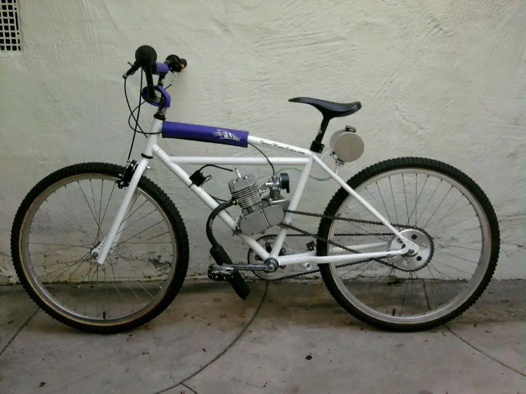

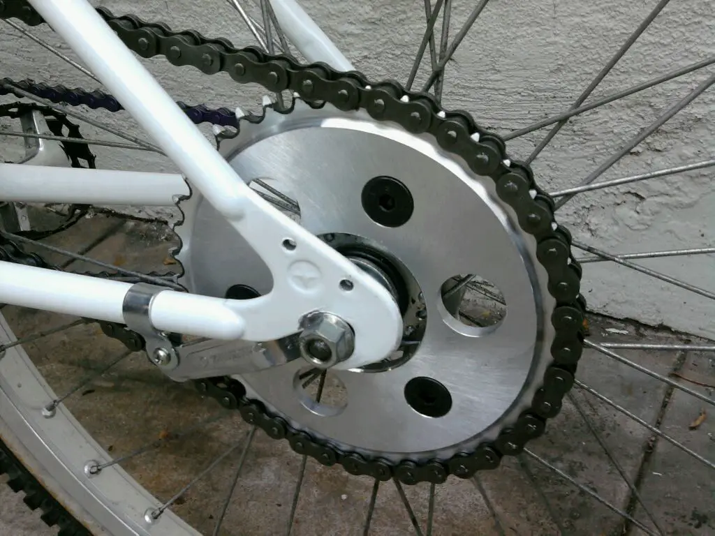

The 'So-Cal' crew has been doing 'rigorous & brutal testing' of these sprockets & adapters... They bolted up & adjusted without any problems & have stood up to 100's of miles of very hard riding! (even some jumping!!) ;)
We feel that these are going to be real winners!! (^)

That's a nice build there Venice! I like the large BMX look. The sprocket and adapter SURE look good on that bike :D

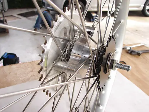

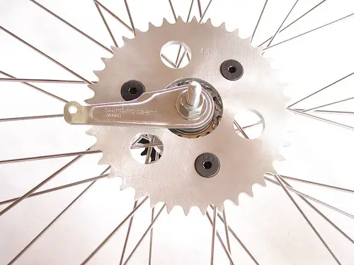

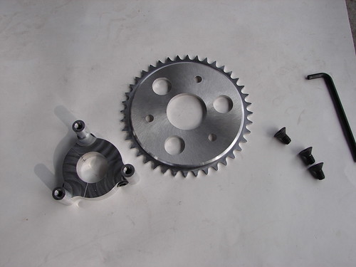

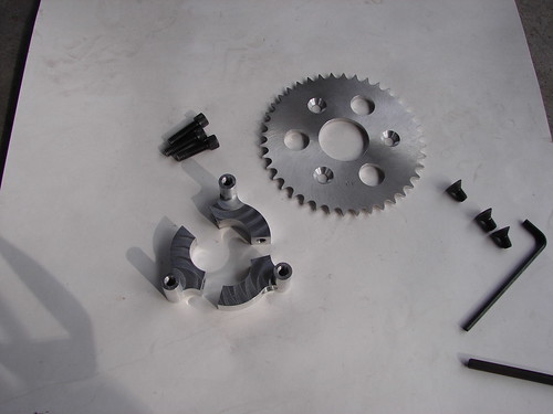

Here is a new product I have been developing. It is a sprocket adapter with a few new features. The adapter assembly is of a three piece design. This makes it very easy to install through the spokes and because each of the three clamping parts are identical it is a balanced design.
DSC06064 by Sportsman Flyer, on Flickr
DSC06066 by Sportsman Flyer, on Flickr
Here is the assembled part mounted to a Worksman coaster brake wheel. Notice there are no clearence issues with the bolt heads and the coaster brake arm. Brake arm is unmodified.
DSC06067 by Sportsman Flyer, on Flickr
Here is another picture of the installed part.
DSC06069 by Sportsman Flyer, on Flickr
Please offer any suggestions or comments you may have as this is a prototype unit and I have time to make changes or modify the design. One thing I will probably change is the width of the clamping area. Since the three parts are so small they easily install through even 12 gauge spokes so making the clamping surface wider will not be a problem. I will also have the teeth on the sprocket cut with a bevel. The sprocket manufacturer assured me this was not an issue, but production units will have this feature added.

Is there a way you could "Key" the inside part so that there is no rotation, thus no pressure on the spokes at all? Thinking this might be an advantage.
I have yet to have this current design rotate. It is solid with three clamping bolts. The production HD version will have an even wider clamping surface as well and taller standoffs.
Needs a grove around the center inside of the adapter to hold 3 piece adapter shim sets in place for different sized hubs,xct2
