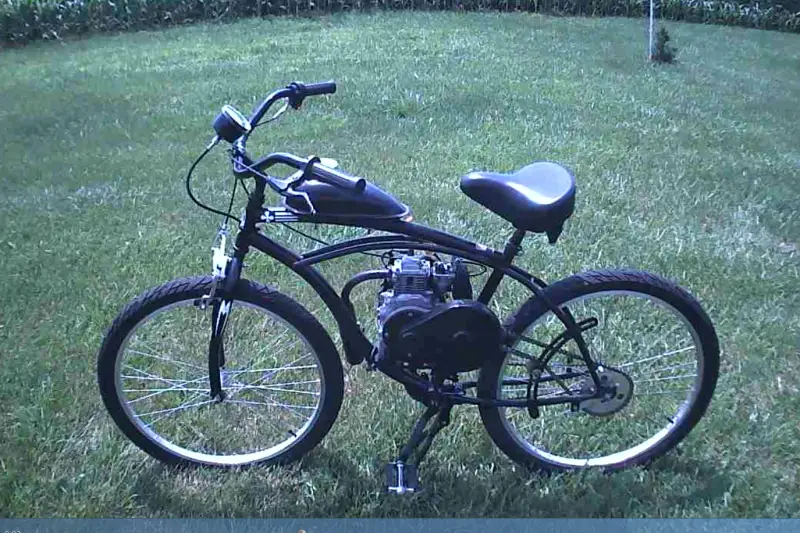

Hi Rick, had to take the bike into town to get some gas for the lawn tractor and I took four pictures of my old 49cc build
and the 212cc. Since there is no kickstand on the 212 I used two block to support it. I'm waiting on a new kickstand
to come in maybe later today? I've got a lot of parts I need to get on order and no time to mess with the bike since I've
had so much outside work to get done this season.

Got several parts in today and the one I was really needed was the kickstand. The 30 lb. engine actually needs
a sturdy stand like the scooters and mini-dirt bikes have. The new stand seems to be working out and the stock
one plus the other one I bought didn't. I ended up putting a better kickstand on the 49cc last year after having a
wind gust collapsed the stock one. The Micargi had the worse one I've ever seen quality wise and the Sixthreezer
seemed like a heavy one so I suppose I got one with a flaw in it. I think work on this bike will go through the Winter
and right now I've got too much work outside to catch up on. Mowing this year has kept me busy plus working on
the tractor and buying parts for it to keep it running.

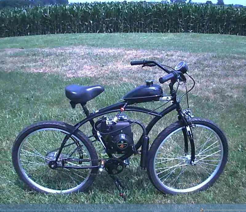

Do you realize the front fork on the 49 cc is on backwards? Nice bikes..............Curt
Thanks, I assumed when it came in from the supplier several years back it was right, joke on me! :rolleyes: I've got it for sale
and a friend wants it. The 49cc has the "Ghost Racer 7G" on it and hasn't given any problems except it requires a lot of
weekly maintenance on the transmission and engine runs real good.
I got the pedal arms to clear the engine housing and the transmission and I am thinking about welding a engine mounting
plate to the bike. I haven't tried to see if the head would clear in the upright position and that would require repositioning
the carburetor along with several other things to do it. The rear forks are wide on the bike since it had a 7-spd. cassette
which I am getting rid of by changing to the aluminum mag wheels pretty soon. This one is going to take some time to
get it running the way I want it. I ran out of oxygen on the torch and I suppose I will have both tanks filled pretty soon to
do any further work on it and any other work around here. The darn grass is growing and I've got acres to mow. :(

I got the kickstand in and got it on the bike. I set it up so there is not too much lean angle on it which could put too much stress
on the kickstand. I have the double kickstand on the 49cc and it works real good on it but they aren't made for supporting any
weight on the rack. I had a 4 gal. tank of fuel on the small bike last year and I never used the kickstand but just leaned the bike
against the building. Then, I found the problem of getting on the bike while the gas can was on the rack! :oops: The best way to
get on the bike was to set the gas can down, mount the bike then pick the gas can up and set it in the rack. The best way
always with/without anything on the rack was to put the bike near a curb or sidewalk, mount the bike from the curb.
I am thinking the best way to keep the weight off of the bike is to get a trailer for the bike if using it to take a jaunt to a store
for anything. Last year I used the little bike for fishing and a trailer would be the way to got for tackle boxes, etc.
