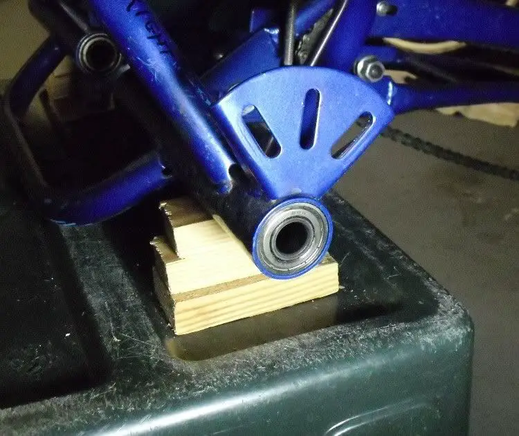

Before I start banging on these bearings with tools meant for things other than banging on bearings, could someone please take a look...?

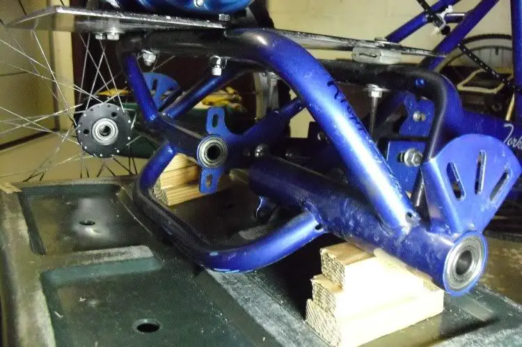

I hope this doesn't take buying another tool, but I need to replace a bunch of bearings in the rear housing unit of my Torker trike. There are (4 - 2 ea wheel) identical bearings in the wheels hollow hubs that I need to replace as well. Eight (8) total bearings.
The bearings themselves are inexpensive enough. Although I suspect replacing them with something a little heavier..on the duty side, would be desirable...but; Is there a special tool required to pull these out...and in turn put new ones back in? I certainly hope not but I don't want to mess things up by using something totally inappropriate. If I DO need another tool for this, can someone point to where I might find it, how much it might cost and if there are any alternative ideas to removing and replacing these? I just can't see buying another tool to replace a part that costs about $1.50 (ea).

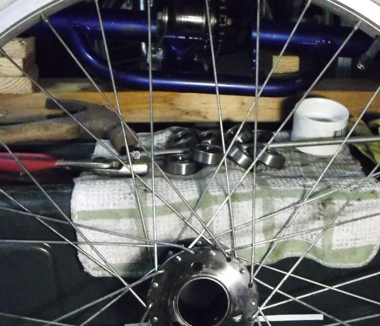

Another forum member suggested a steel rod to fit through the bearing holes, carefully knocking out the bearings from the opposite ends. And after finding out that they are seated in there with a mere tight fit, I think I'll (carefully) give that a try first.
I am very appreciative though. VERY! It's the thought that counts! Thanks very much...and if I break stuff and end up cryin', I'll let you know for a "told ya so".

Alternately, you can bash them out from the backside like you've stated, just take your time and be gentle. (you'll ruin the bearings, but they need to be replaced anyway, right?)

with the long bar method you need to switch sides as you are driving them out.
If you get the bearing jammed in sideways your not gonna like what will happen to the tube its sitting in. Nor will you like how much fun it will be to put the new bearing in...

I use this method at times...work on each side of the bearing 12:00 and 6:00, or 3:00 and 9:00. I even have a 4' and 3', 3/8 drive extension I can put a socket on and remove the last bearing on either side.
