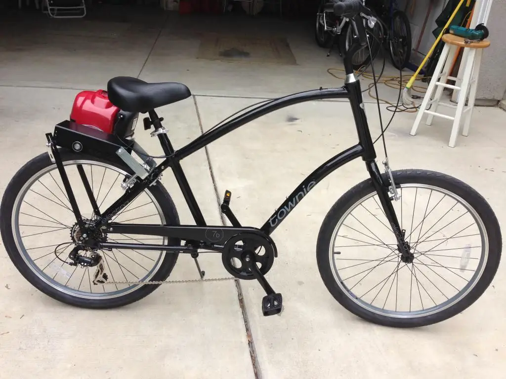

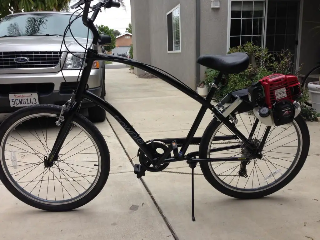

Gentlemen, I do appreciate the responses. And from my online research, it seems the motor does not have to be parallel to the ground although I do plan to add some extensions to get it level for no other reason than esthetics in my opinion.
The bike does have enough power to haul my 200 lbs around. After proper break in of the engine, i am anticipating some increase in power. A very pleasant ride and completely different from my CG and Dyno/HF bikes. To me they all are great.
So here are some picts of this basic transportation.
And the Townie is a most comfortable bike to ride. Being tall I ordered the 7D in their tall version and glad I did.

Thanks for the picts. I love the looks of the Electra Townie. I hope that when Trek bought out Electra in January that it doesn't change the quality.

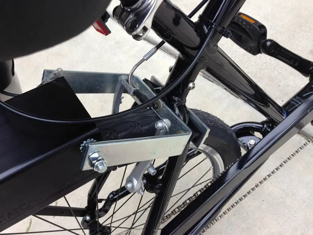

To get your motor straight up and down so it is more astecically pleasing, Thatsdax.com sells a longer U bracket to mount the frictoin drive channel to that comes with his friction kits. You might be able to find out if he would sell individually. Hope this helps.

Very cool looking, PoorBoy. Has a funky, Euro sort of look.
