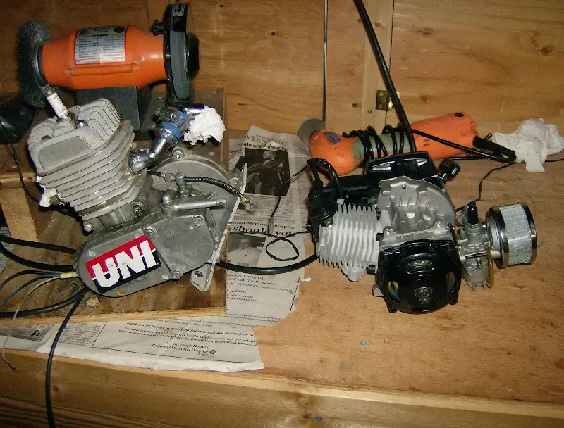

I am actually starting my pocket bike build I have been rambling about all over the forum! I have the cvt on order and should get it later this week, i'm pretty stoked to see how one of these compares to a china girl.

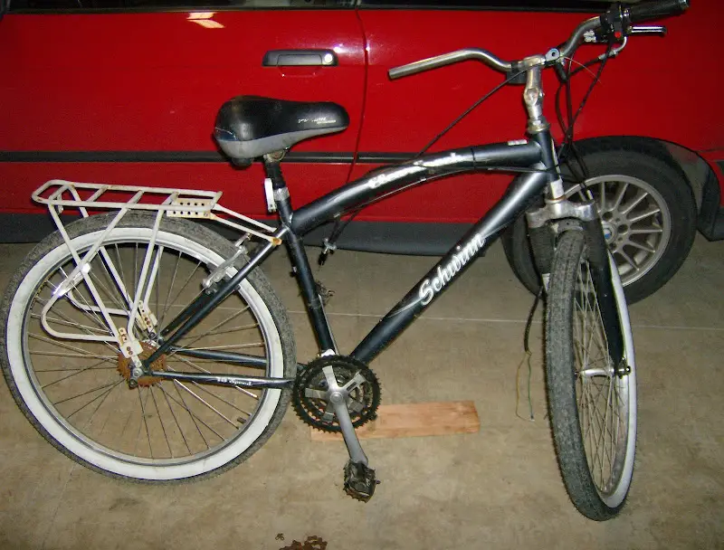

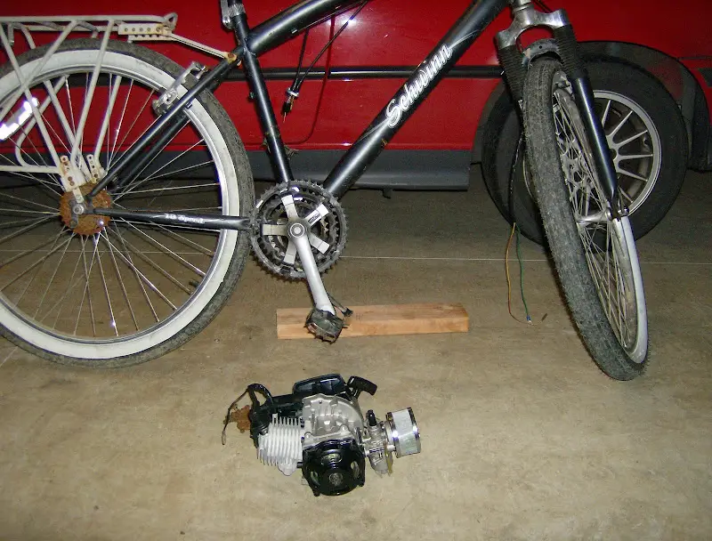

I have the same motor and already tried to mount in frame lolWell, I got the cvt and realized that there is a reason no one mounts them in frame.... with the cvt it is over a foot wide and way to bulky to allow for pedaling.... so I think this is going to become a rack mount...
Bobby, you'll still need the chain-drive transmiission, which bolts onto the pb clutch. With its 3.25:1 gearing, that'll give you 18.75:1.....perfect for starters.wow cool build im starting a worksman frame with same motor in frame no transmission. 12t front 72t rear but idk yet. friend on here said 40mph top speed. and u going in frame?
