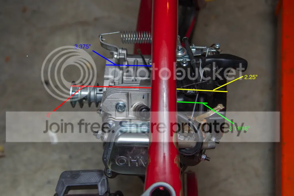

I went to the store and picked up some pulleys to mockup the 2 spd and put the pull start back on. The pic below shows the measurements I came up with and it looks pretty wide.

will it really get much narrower with it off? still gonna have the flywheel etc.....I guess if you dont feel you'll mis it..go ahead....me, id like to have the option. looks like you have a good start there.....keep us posted

If you remove the recoil (pull) starter, AND the cup for it, AND the cooling fins off the flywheel, the engine does get a good bit narrower. You can also take some length off the output shaft but make sure you have enough left for your pulley or pulleys. I assume you're thinking of a jackshaft with 2 driven pulleys, then back to the rear sheave with another pulley on the jackshaft ?
If you have a center or rear stand that gets the back tire off the ground, the lack of recoil starter should never be an issue.

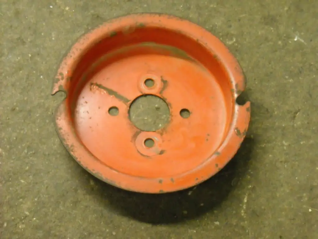

Here's a picture of a rope starter. Might be able to adapt one to the Predator:
http://motorbicycling.com/attachment.php?attachmentid=55022&stc=1&d=1357359273
