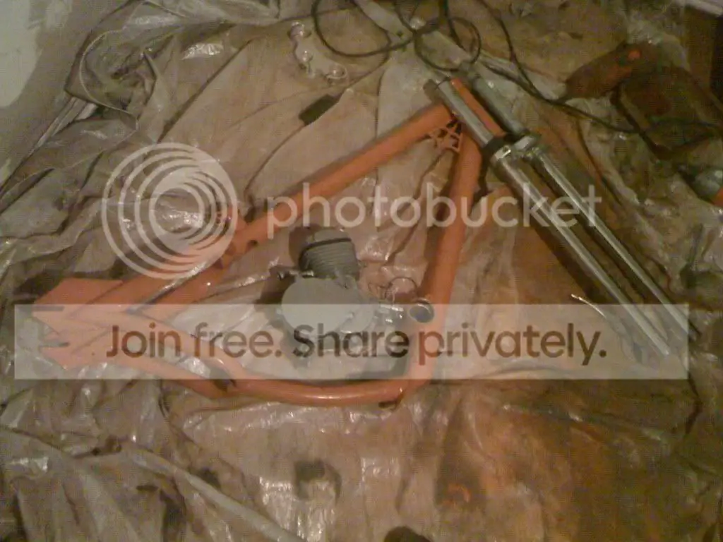

Well here folks is what i have so far on my custom gas bike, it wont have a pedal drive as im using a scooters rear wheel.
It used to be a Black bike, a jesse james chopper bike
Painted it orange, figured the black and the orange would look pretty awesome

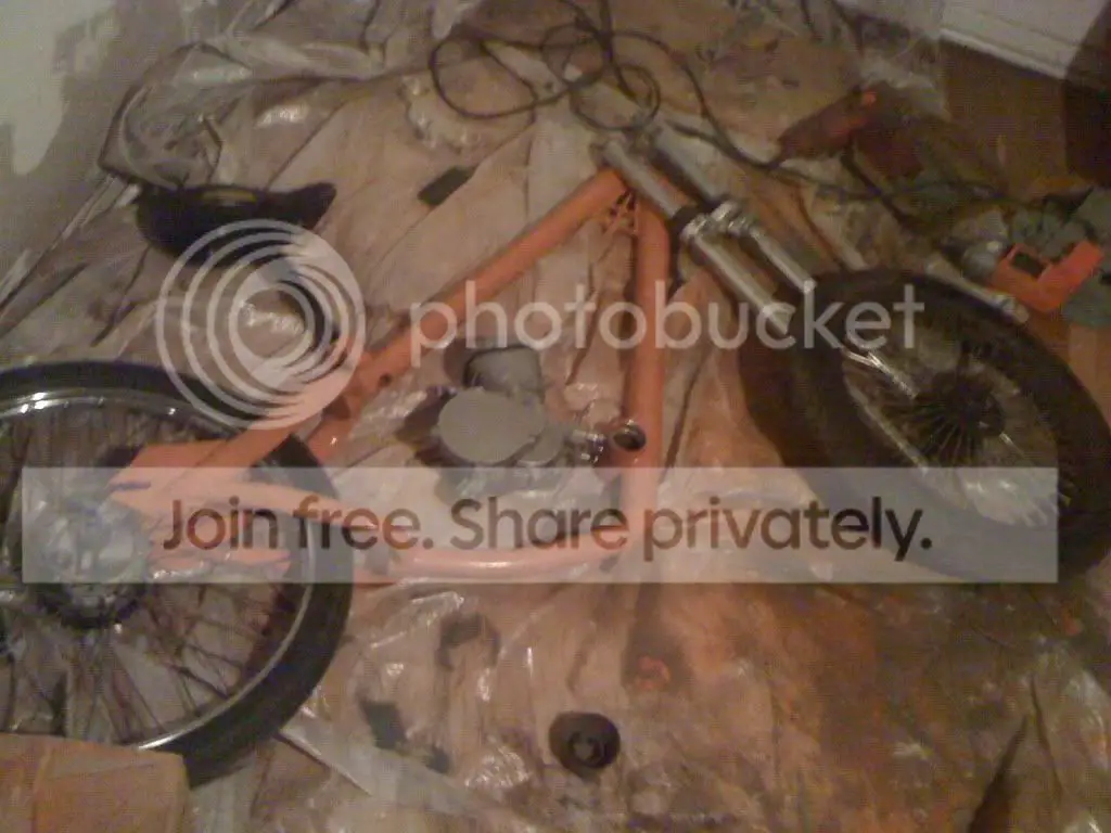

This is a mock up of what it will look like.
More photos of the build coming up in the next few days!
It will have a rear drum brake, as the scooter wheel has one built into it, good stopping power!

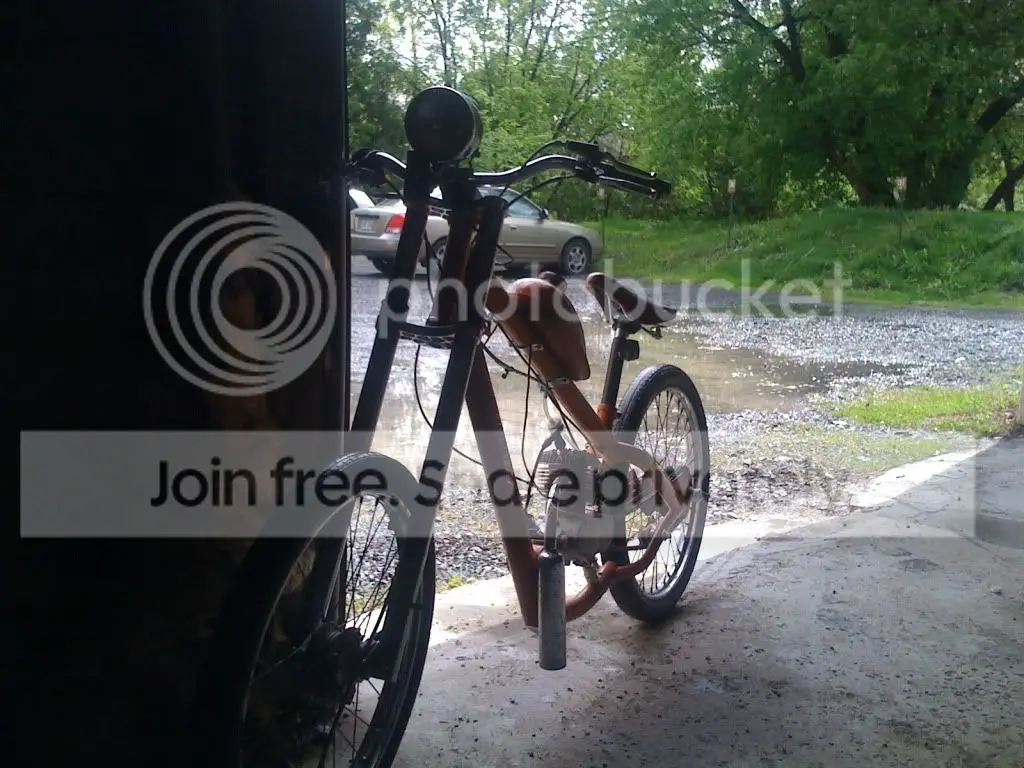

Allright so im updating the thread, the gas bike is nearly complete and is in a running state now!
Due to the rear wheel being from a scooter, (It was just by chance that it actually fit and was the right sprocket) i have not counted the teeth, but its probably somewhere around 20-30 teeth. This give its a good top speed, but its hard to get it off from a stopped position, the engine struggles to pull the bike at low speeds...but excels at top speeds of 65 km/h +
Note in the picture below in the back of the bike you can see my older gas bike...

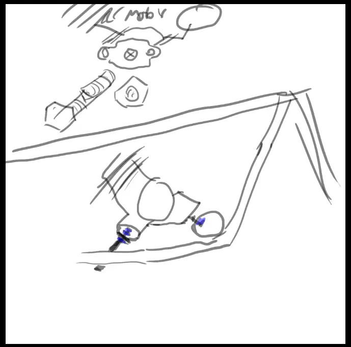

I had no problems with chain rubbing, I built it a mount for it that mounted with two bolts that were drilled into the part where the pedals would go. I also drilled a hole in the frame for the chain tentioner, once i found where it needed to be, this kept it from rubbing w/ the frame.

the back mount consisted of a large bolt going through the frame at aprox a 45 degree, it was attached to the frame u clamp thing, a hole drilled in the center, the motor mounted to this.
<-- drill hole where x is, use a big bolt!
the blue is nuts

its not into the motor,
Its the clamp that usually goes around the post of the bike, which the two studs that come out of the motor attach to, i drew it in the top left corner, sort of lol.
