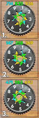

D daveet6666 Member Nov 3, 2015 124 19 18 59 Omaha ne Aug 19, 2019 #1 does anyone have a diagram for star pattern on tightening ragjoint sprocket? gonna give this ragjoint one more try! thanks
