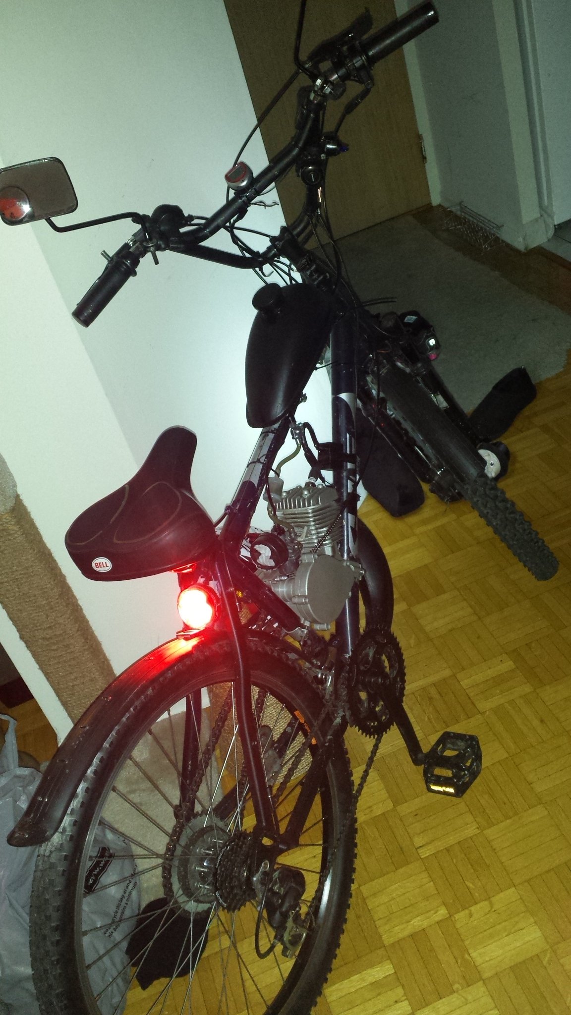

I went out today and bought a ZB-JET80-BK lol. Yes a 2014 grey new chinese bicycle engine kit. I went home and within 3 hours i had all new stainless steel mounting studs in it. I assembled the top end of the engine (piston and all) cleaned the crankcase with brake cleaner (upsidedown) 2stroked oiled it up (nice and smooth) and had it on my bike ready to ride. Which i did.. and which i can say it kicks ass cause i know what im doing..compared to my first build. Im hitting 50kmh already but i dont wanna push it. Oh and when i changed the jet one size larger... i forgot about that while riding on my new engine tonight and was like damn this thing has some crazy torque.. but then i remembered when i got home and was like oh yeah.. it seemed to work and this thing is a hog. It seriously reminds me of a motorcycle or and enduro it has that much balls. I will post pics or a video soon if anyones interested.
Now for my advice. Change your damn studs every year of riding. Cause i have a perfectly good engine that i cant mount and it hurts my heart for the poor thing. (I need to take the crankcase apart and swap out the one side. Then she'll be happy again)
Also if your bored and want some crazy torque notch out your throttle pin a few more notches and go richer...insane. i swear i can almost do a wheely if i pulled up.
