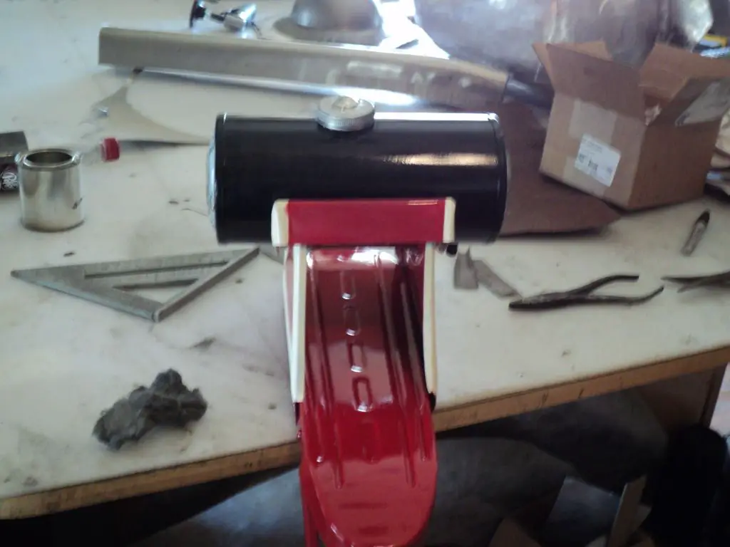

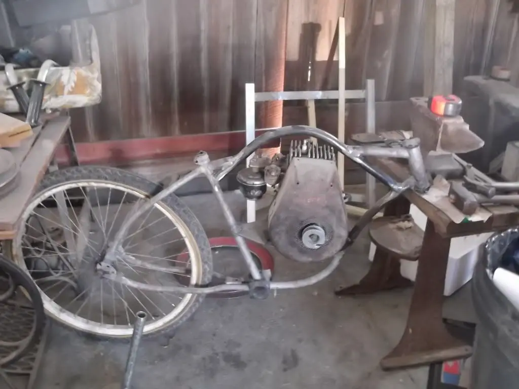

So I've been working on this bike for awhile and I'm nearly done with it! It's a 1 1/2 horse Clinton engine on some old 50's bike. The paint job isn't the best because it fell over and messed it up a bit. I still have to connect up the throttle and fix my centrifugal clutch, but then it'll be ready to ride!
