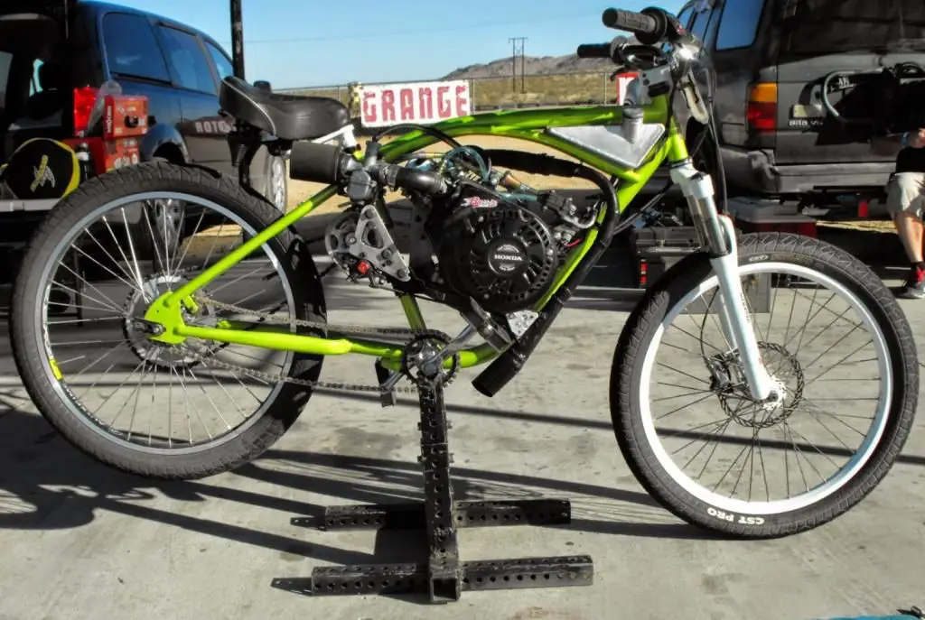

Here is an exception for a single speed build and it has no coaster brake and really doesn't even need a rear brake as the engine does the braking when you let off the throttle.
I do run a front hydraulic disc brake as front braking is a must on this bike that exceeds 65+ mph. And I have raced this bike before with no rear brake at all and was just fine...
I would never install or rely on a coaster brake on a motorized bicycle......period! I wouldn't be here today if I did. ;)
