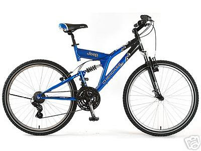

I like everything about this build except that the roads here are terrible. I think it is the same all over town and probably all over the country. I am looking for a full suspension bike again. I had one but junked it out. I think this system would work well with a full suspension.
I want to get a used one. I hate to screw up a new one. I have to remove the rear wheel to put my wheel on it. Also I hate those mountain bike handlebars. I like to ride sitting up not all hunched over. So anyway here I am for better or worse.
I'll post a picture of the junker when it stops raining.
