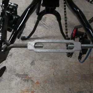

O.K. so remove it and flip it teeth in. The fix could be that simple. I have had to spread the frame a couple times on different bikes - even with teeth in. I use a turnbuckle from the hardware store and spread the frame a little beyond where it needed to be. The reason is to Not induce stress which will create a fracture point. Just go ever so slightly beyond your spacers (washers). This will allow the wheel to slip in with washers in place. You want the frame stays to relax exactly where they need to be. That is the objective when spreading the frame. NO STRESS vibration will fracture @ stress points.
