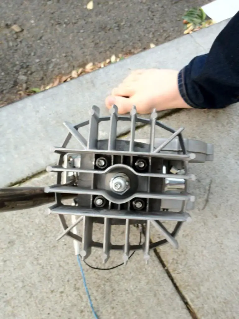

this is a little nit picky but the regular puch heads have had a smaller bore than the china girl cylinder in my experience. This can be a problem when running a close gap between the cylinder and head. Solutions for this problem are either a thicker base gasket for slightly enlarging the squish of the head, either by milling or with a dremel. This issue may not apply to everyone but has been common for me. A great way to get around this is to buy this head: https://www.treatland.tv/puch-gilardoni-74cc-head-p/puch-gilardoni-head.htm
* they are temporarily out of stock but should get more real soon. This head actually has a 47mm bore! and its HUGE! which could either be a good or bad thing. It runs super cool. There is some tomfoolery involved with getting the right sized socket wrench in between the fins if your running 13 or 14mm headbolts - nothing too bad, just a little sanding to open up the fins a few mm. Just another option for those interested.
looks like the new fin pattern of the puch Hi hi head, but I'll add it as an alternative to the first post. And yeah, I figured all head bolts were 14mm which is... a pain to say the least with the puch heads, but the acorn nuts, as bad as people claim they are, will be a godsend at 12mm. You're right, the 14mm nuts, even using the thinnest socket I can find, are a major PITA, I have to use my socket on just the edge of the nuts or else it'll get jammed and I have to unscrew it again just to get the socket out, this is AFTER grinding the fins down (doing it with a dremel hits the harmonic resonance of the head and it gets painfully loud).

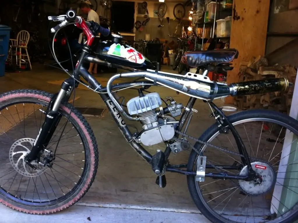

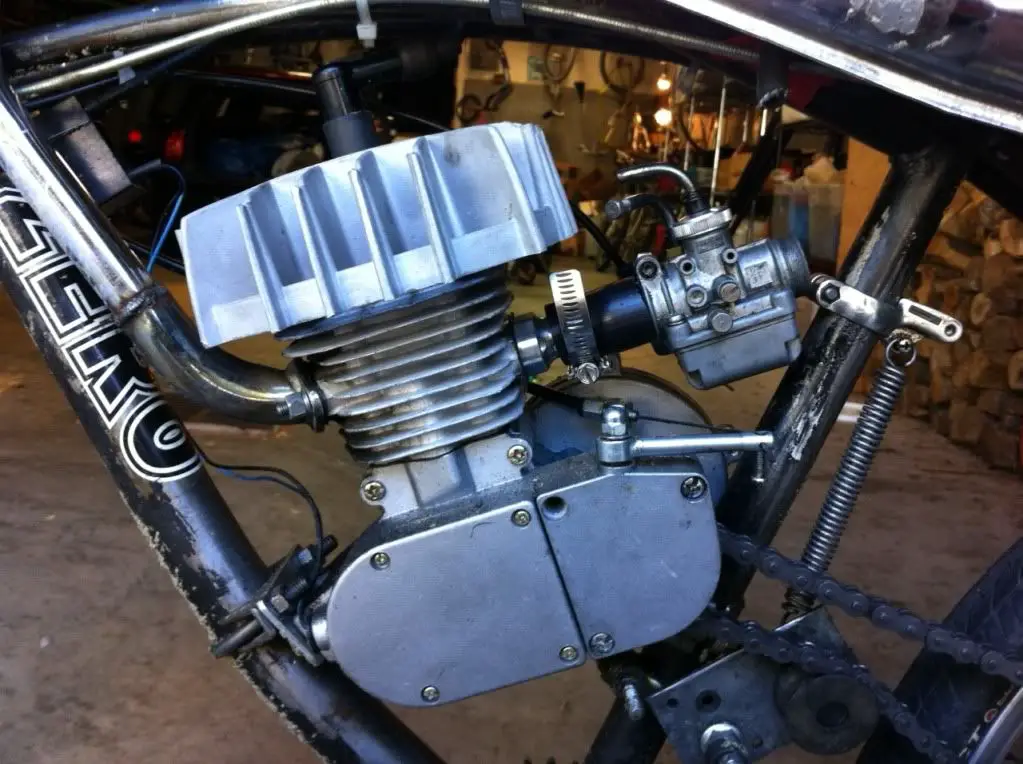

I use m8 12mm nuts if I can find them - they make the whole thing much easier. As far as the head its much larger than the hi hi head, ive run both on my bikes.
this is what it looks like:
That head give the bike a retro Devo look........LOL!
That thing must cool like a mad man now, also I'm looking at the carb you have on the engine and wondering what it is...?

I've been running the puch 74cc head for months. Awesome cooling and a new look. I drilled out the bolt holes 6mm to 8mm and uses head cap bolts that use a Allen wrench and took care of the problem of screwing around corners.

its an amal carb, great in principal - I just never really fully set it up and a dellorto ran a little better.
btw. thanks for putting the links to the dellorto phbg carbs on this list - im running a 21mm one from those guys and its great!
