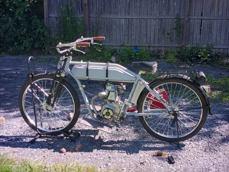

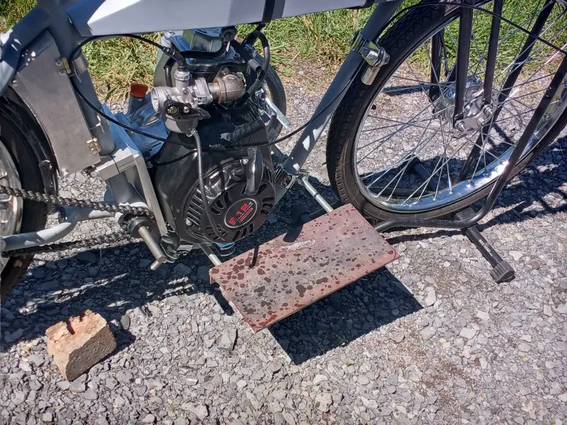

Update 6/23/21: The bike is finally back together. I spent the better part of the week repairing the back wheel. I had to shave down every spoke otherwise they would have punctured the tire again while truing it. I got it running on the stand as well and I'm glad I did it this way. 3 major issues I ran into. 1: The breather tube spits a ton of fuel. I'm sure there's a minor fix, but I'm not knowledgeable enough so if anyone can chime in please do. 2: The engine actually has too much power on start up. Even at idle the bike just moves the back wheel very quickly. I don't know if this would change once it's on the ground with 160 lbs of weight on it, but I'd rather do more testing than crash. and third: the cvt drive actually sheered my shaft key right off. I'm going to assume I need a solid steel one instead, but if anyone has a better idea, let me know. Other than that the bike looks great. I really want to get started on the sidecar as well, but for some reason I'm just having a major mental block about the design. James65 and silverbear have some amazing designs for theirs and I wanted to do something similar. I'm using heim joints and a pull behind bike trailer for the base, but Can't figure out the pivot system for a btr frame. Any close up picks for a design would be helpful.

As far as I know the only aluminum key is used on flywheel of engine. Anyway on Briggs that's what I have a small package of spares for. HF has a nice kit for cheap of all different sizes of steel keys that come in a plastic case with dividers. The clutch on my bike is the steel key as well as jackshafts pulley an sprockets.
The engine you have is the HF I think I see. If I'm seeing it right the engine is tilted maybe 60 degrees forward (counter clockwise). Something maybe to do with that. Others know more on HF. I tilted my Briggs backward 20 degrees and it was OK. Something was said about how much oil to use, if it is different due to the tilt?
Others will probably chime in on that.

you can buy aluminum keys for regular shafts easily. there's no issue with tilting a predator engine 90 degrees. It just requires extra oil and a sensor disconnect. That shouldn't be causing any issue.
I sent you a DM... please call me if you need help with this.
