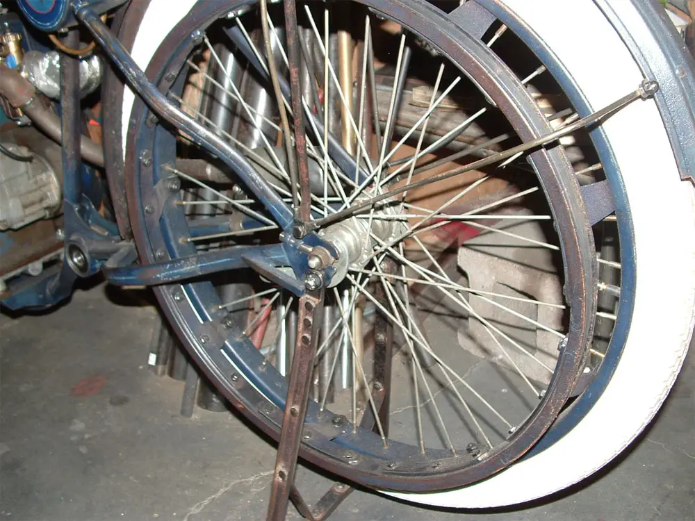

I have decided to change by motorized bicycle to belt drive, and I need some help with how to attach my smaller rim to my wheel, I don't think welding to the spokes would work, so I need some suggestions.
Thanks!

I used a old 24” rim for a flat belt system on my 26” “retro antique” project.
I made 9 brackets bolted between one rim and the other just like they did in the early days of motorcycle building.
The only difference is I extended the width of the brackets on the 24” Pulley” side to cover the spoke holes. I also lined the pulley with leather just like they did in the early days of motorcycle building...
But in order to do this you will have to widen the left side wheel stays
-Kirk

Thats a very cool looking set-up, did you do a build thread on that bike?
