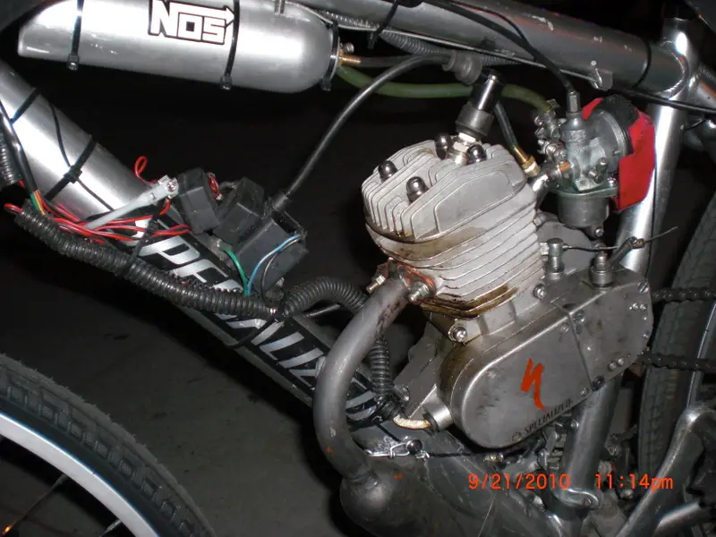

I made a Boost bottle from a old used butane gas aluminum can(5.7oz, 162gm) that I spray painted silver, then I tap and die a hole in the intake and in the top of the can, then I threaded in a 1/8" brass barb fitting in each, then attach the bottle with zip ties under the gas tank ,and connected the can and intake with a hose. Before the boost bottle I top out at 30.5 MPH and after I just top of at 34.8 MPH. Well I'm headed out to do some more riding, because I live downtown Washington, DC and there's too much traffic during the day to really have fun, so I'll post some pictures later on & update you if I went any faster..wee.

Hi C, It's function is to absorb & release pressure pulses within the intake vein, assisting engine breathing. Now an explanation of exactly what goes on involves a lot of physics and a good understanding of fluid dynamics & pressure zones, but can be explained rather easily. During the intake stroke, air is sucked through the intake manifold and into the port at a considerable velocity. Because of this velocity, the air is said to have relative inertia. Now, when the intake valve closes, the kinetically charged air suddenly has nowhere to go, creating a high-pressure area. Naturally, the air wants to release its pressure in the easiest way possible, so it tries to shoot back out the way it came, creating a pressure wave in the opposite direction we want it. Then no sooner dose the wave begin to travel, the intake valve suddenly opens again leaving the motor to try and pull the pressure wave back in again. This dramatically effects low RPM, wastes energy and kills low-end performance. Now the same engine, but with a BOOST BOTTLE. Air goes whistling down the manifold until the intake valve closes. The air, still all charged up with energy tries to escape back up the manifold but is met with a small port that has a residual vacuum. This vacuum being caused by the previous suction of the intake stroke, sucks most of the pulse inside the Boost Bottle, storing much of the pulse’s energy. The intake valve then suddenly opens, creating a low-pressure area outside of the Boost Bottle. The gasses then shoot out of the Boost Bottle, directly into the intake system as a pressure pulse, instead of having to be pulled in by the piston. More air is then also pulled in from the manifold to completely fill the cylinder… Thus giving you an additional boost of power. If your ever downtown give me a call 202-520-1115 and we can go grab a cup of coffee, and if you help port my intake & exhaust, I'll help you make a boost bottle.
5.7 Oz computes, because one resource told me the bottle should be ~50 cc and that is slightly less than 6 fluid oz.
But your bottle LOOKS much bigger, looks like a good 12-16 oz.
Is this 50 CC guide real ?? correct me on the apparent "bigger-than-50 CC -perception" given by your excellent picture

Question: How on earth do people honestly think that any signifigant amount of air is gonna make it through that 3/8" ID tube (at best) to the bottle?
Has anyone here tryed making a boost bottle with a nice short 3/4" or larger hose to it?
Anyone else here port matched the intake and realised that even a little bigger is WAYYY better? So why do people use such tiny hoses on the boost bottle?

A funny little about using small diameter tubing for connecting boost bottles....I used to use clear surgical tubing on mine. After installing and resetting the idle and air/fuel mixture and getting it all dialed in, while sitting with the engine idling I'd pinch the tubing with my fingers and it would kill the engine. I'm serious. I found that surgical tubing worked much better than tubing with a higher durometer (stiffer).
Here's a cut and paste....and interesting read....
Boost Bottle
How does a Boost Bottle improve performance? Air rushes thru the carb on the intake cycle. Ignition accelerates the piston down, forcing the reeds to snap shut. The momentum (inertia) of the air has to go someplace. It goes back thru the carb causing a double rich mixture. The result can be rough idle or hesitation.
Due to the high velocity of the fuel air mixture through the carb boot, we need to take advantage of this momentum/inertia energy. The Boost Bottle and tube provide storage for the fuel air mixture between carb boots. The energy (pulse) forces the pre-atomized mixture in the tube from the previous cycle into the adjoining carb boot where the reeds are just opening and ready to receive the fuel air mixture. The boost bottle and tube provide a "boost" supercharge effect to each cycle.
The boost bottle is most effective at lower and mid-range rpm, and, when you are on & off the throttle. It assists in filling the cylinder (shorter distance) for a fraction of a second until the carburetor venturi gets enough velocity to fully atomize the fuel. The advantage is that it brings up the torque and horsepower in the bottom of the rpm range, up to where the pipe(s) starts to work. There is a small benefit at high rpm's.
What Size? Singles = usually the CC of one cylinder or larger. 700cc Twins = 300cc boost bottle. 700cc Triples = 225cc.
Variables: Engine CC's, Carb Size, RPM below pipe, Number of cylinders. Large carbs like larger bottles/tubes. Triples like smaller due to less time between pulses. I use the TSR computer software to calculate the Boost Bottle for a specific set up.
Yes they work, when the size is right, the inertia of the air is stored like a spring in the boost bottle to help charge the next cycle. Try tuning a Yamaha Phazer without it's boost bottle!
Power valve engines may not have similar performance gains because the valves will keep the bottom end crisp. Testing w/ powervalves will probably show gains off idle and low bottom end. Is it worth it?? That depends on what you are willing to pay for some torque and a couple of horses!
