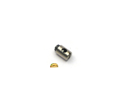

For future reference, you might want to opt for solderless nipples which simply incorporate a grub screw to secure the cable.

Yup. That's the solderless nipples I mentioned in post #4 of this thread.
Adding the art of soldering to anyone's arsenal of skills is worthwhile - but solderless nipples are an easy option. Keep a range of these in your spares kit.
