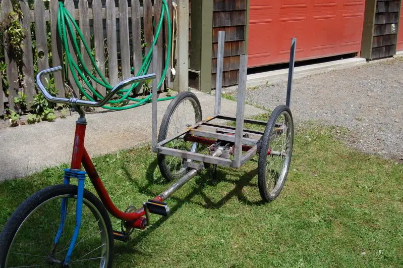

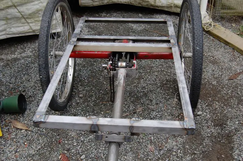

After 2 and a 1/2 days of solid rain it cleared off this afternoon so I got the frame for the box drilled and mounted
If this fine weather continues I'm hoping to get some more done.

Hot, smoking drill bits but thankfully there were only two holes to drill in the bed rails. The other two were in normal steel.

Got more done in between rain showers. Thank Heavens I've been to the advanced course at the Silverbear School of Creative Staring and Bicycle Building because it's come in very handy the past couple of days.
Lots of plotting and planning but not enough to photograph. Just don't think that a few holes are going to grab anyones attention.
Had to tweek the rear part of the frame since the someone had messed with where it met the rear axle. Now it's straighter and lines up correctly.
I bought a triple tree set of front forks from Cycles U.S. They had a 30% off sale and I was able to catch the end of it so that helped. Thirty % off worked for me and I'm sure that it will be a few days before they get shipped because they must have been swamped with orders.
I'll call the plywood shop tomorrow and see about body panels and see if I can get the seat post welded on.

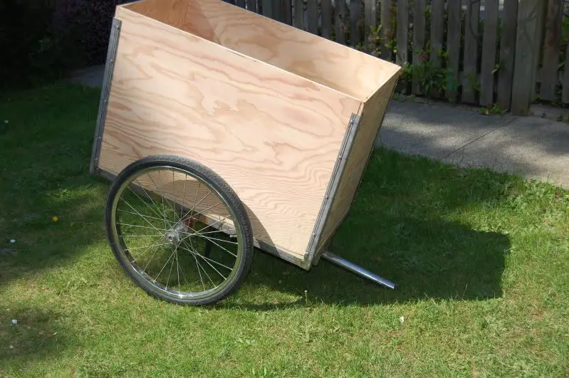

Rain has finally stopped so I was able to get somemore done.
Looks like it will work so I'll take it apart and prime the frame and the wood.
Top will hinge on one side to make it easier to get into.
I'm going to pad the top and cover it with Rich Corinthian Leather or maybe Naugahyde.

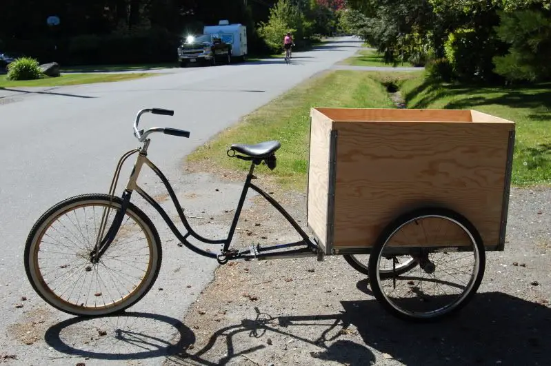

We live on a bit of a hill and I started thinking that it would be a good idea just to coast down it to see how it handled so I pushed it up towards the top and got on it and off the adventure started.
Neighbours were impressed and were waving and yelling, looks good, and I have to admit that I was just a little puffed up with pride as we streaked for home. Now that old hill is just a tad steeper than it looks and as home plate got closer I went to slow down and I thought it was impressive that a guy who's crippled up could lift his foot up that high to push down on the front tire to slow down. The good news is that the brakes were at home safely in a box so they didn't suffer any damage.
During all this excitment I made the interesting discovery that when you put 250+ pound of pork on the seat it tends to jam the steering so it doesn't turn really well. Plus the problem that I'm going to have to skim past 2 cars and my camper and the rather steep ditch with which I've already lost one battle.
Sucess was very brief. As you know we have the famous soft pines here on the mainland, hence the name Pillow Pines and we have a dandy here in the front yard that is 12 feet around and a source of family pride.
I was able to gently kiss it with the front of the trike and at the same time realize a life long desire to do a hand stand. The best part was that my leg wedged itself between the trunk and a branch so I was able to keep doing the handstand until fully half the people on the street were able to marvel at that feat of daring and physical prowess.
As my brother was off looking for a ladder in the back yard so he could get me down, my pant leg ripped and I was able to reverse the handstand and land on the bike seat upright. Some years ago this would have been the source of greater pain but fortunately the intervening years have lessened the pain center to the point that it is now just uncomfortable.

OK. What really happened to the original trike front end. It had a bend just in front of the pedal crank as well as a twisted head tube. My bet says that someone ran into it with the front of their car when they pulled into the garage and just nudged it enough to make it unusable.
When I sat on it the handle bars went to the right at an impressive angle. We took the forks out and put a piece of pipe in the head tube and got it straight but once it had weight on it they went to the right again.
I cut the down tube and was going to straighten the forks when I saw that the down tube was bent at the crank so I just cut if off and fit the Schwinn to it
The Schwinn is a 1942 The World. Silverbear bought it from the original owners sister who also used it. Her name is Dorothy and Silverbear and I refer to it as Dorothy's bike. Silverbear was kind enough to give it to me when I was coming home last summer and it has been sitting wrapped up in the trailer waiting for it's chance to once again ride the roads. I hope I've done it justice.
I'll put it away now until I get a Cyclone electric motor that Pops is holding for me. It's an add on motor that drives a second chain ring that is supplied along with the pedals and crank. The motor fits behind the seat post so I won't paint it until I see just what the motor needs to be mounted. He was kind enough to offer it to me a a very much discounted price.
