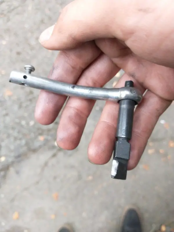

Found the problem lol
Thanks for the help
