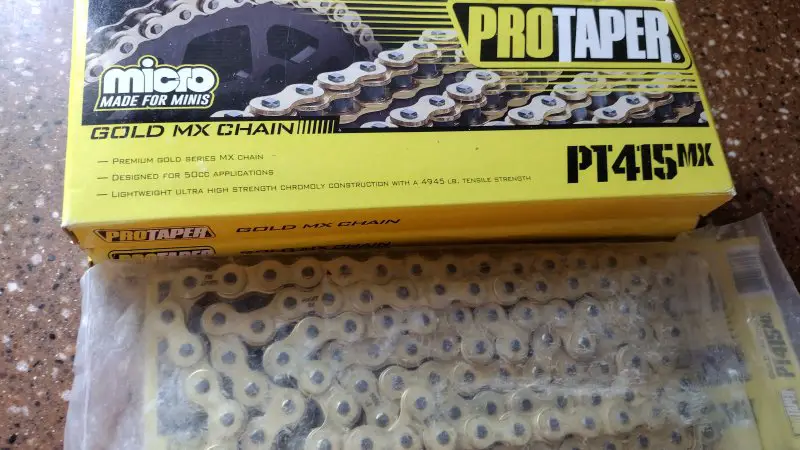

Will keep this in mind if needing another 410. So far my KMC 410 has held up really good for the engine drive. I use a Shimano HG71 for the bicycle gears. Strong chains are a must with shift kits.
Wiperman 410 1E8 wide single speed is the one that I really like also... For 3/16 BMX
Kmc 410H NP was my favorite but there not available anymore...
