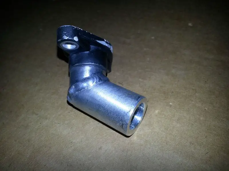

I reworked the intake manifold yesterday and the carb now sits level. Thanks for the info, guys.

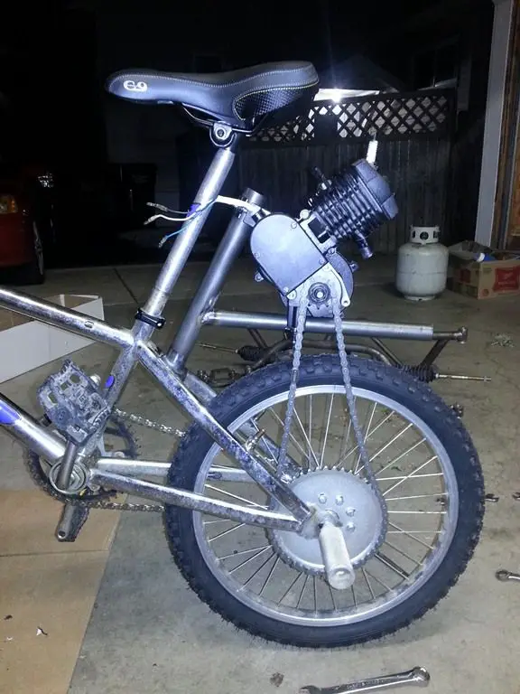

NIce work, very clever.
Since the motor has no oil in it you could run the thing upside down if you wanted to, but the carbs float bowl is gravity based with direct air venting so if it's not level fuel will go out somewhere.
The big question now is what are you going to do with the exhaust as the port looks to be right up against the bottom of your seat?

AWESOME CLEVER:Maybe there is more room then it looks in the picture but a hot spark as well.

The seat isn't in position in that pic. It's loose and falling backward. When in place, there's actually a good amount of space there. I also plan to header wrap the exhaust pipe to help prevent my rearend from getting too toasty.

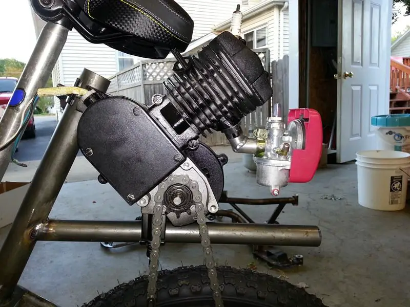

All welding is now done and fuel cell is mounted. Waiting for handlebar grips and the longer throttle cable to come in the mail. Meanwhile, I'm stripping and painting the frame. Still need to figure out what I'm going to do for a clutch disengagement lever. I'll be welding up an exhaust on Friday or Saturday.

You might want to think about something to deflect air into the cooling fins the head might have an issue with airflow over the head a little flap hanging from your seat angled towards your engine might help
